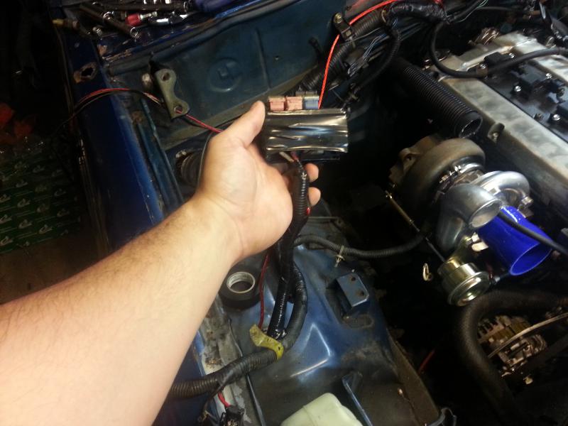

    OK at another stand still on this build... Im trying to figure out how you guys supplied Power to your ecu.... So far I wired up relays for the pump and fan and have everything mounted just need to run fuel lines and weld the exhaust...
    20130722_221610.jpg20130722_221618.jpg20130722_221626.jpg20130722_221638.jpg20130722_221649.jpg

    I powered my mpi relay from the two wires that went to the ballast for the coil on the stock motor. and I think I also took power from the hot wire to the ignition switch. I cant exactly remember as its been a while since I did my swap.
