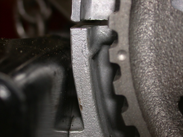

    for the record, subnetting a class C was easier. but its finally fixed! the problem i was having is that i only snapped the large timing belt and never messed with the small one. Also, the factory timing marks were way off and i had to find TDC the old fashioned way. not to mention the cam gear mark was wrong as well.
    It should have looked like this on the cam to head. The book is not clear on the mark. Bad drawing.
    Make sure your distributor was at #1 piston plug wire. At TDC, the first piston, closest to you is No1. The 2 closest valve rockers are loose also to show a closed off cylinder. (meaning compression stroke #1 TDC)

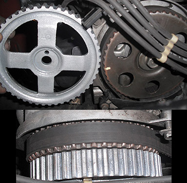

    Below is an image of 2 types of cam sprocket timing gears for the G63's. These are the 1st Gen and 2nd Gen Cam sprockets and the one on the right top is on a 1st Gen G63B engine. The one on left is off a 4G63 engine. Identical in all the perspectives except one, they are not interchangeable like I thought at one time. This is sort of a hidden issue between the G63B and the 463B engines. Now your truck has a square cog belt according to you. Your cam sprocket is identical to the one on the left if I am correct.
    All the other sprockets in the 4G63 are interchangeable with the G63B engines, but this one cam sprocket is the only one that isn't. I know this to be true because I have interchanged all the sprockets except the cam sprocket.
    Now, your looking for a square cog timing belt and your having problems. Well, we know all the other sprockets fit among the two engines and though they look square, they will also use both style belts. This being the Modified Curvilinear and the Synchronous belts. They rounded the edges on the belts to about 39 degrees If I remember right so that they slide into the cogs better and probably are just a bit quieter then the square looking belts. Now if you want to find the square cog belt, well I mean a less rounded cog, your going to have to order probably from Gates. Personally I would call them and talk to them on the phone about your issue. Gates (Power Grip) would be your best bet to get it right since they are huge and make belts for a living. Remember, you want a Synchronous or NON-Modified Curvilinear belt.

    WOW thanks for all that info! This will help me in the right direction. After looking at the pics you posted I am almost positive (without actually going to the shed and checking) that my cam drive is like the one pictured on the left with the four spoke pattern.. Which is a shame because it's not interchangeable.. So basically I'm stuck with going through hassle to find this belt if I ever need it again? No way for a conversion?
