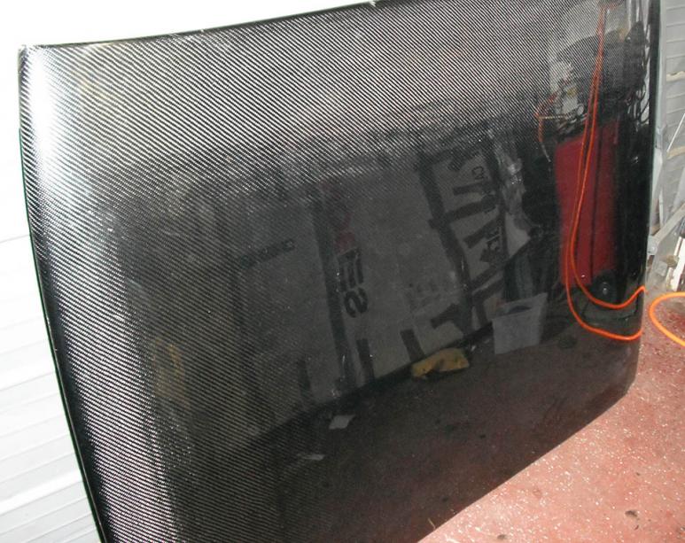

    Know anyone with a 2003 to 2007 Evo Lancer. I have a SEIBON carbon fibor single piece roof panel for one. There is some small fractures on the very edges in a couple spots, but totally fixable. It's in the gel coating and didn't rip the carbon. Brand new $1200, I'd take $200 +ship.
