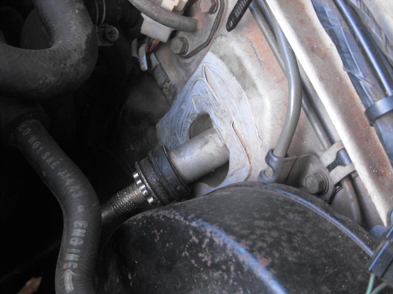

    Aloha
    Here's a picture of the cable under the hood. I'm heading out for a bit but will try to get the pictures of the cable at the trans, and post it later. I did tighten up the star nut by the brake master and it did help with the shifting some, but it is still pretty fussy about going into gears smoothly. I think I can handle the hard clutch if I can get a little better clutch response. My other vehicle is a 91 Miata, and when I switch to driving it after the truck, I about put my foot through the floor the clutch is so light!
    James
    How much free play is there in the clutch pedal? it should be between 1/2 to 3/4" measured at the adjusting screw on the pivot under the dash. If you have more than that, the clutch will never disengage, less than that, and it will never fully engage. If I get a chance tomorrow, I will take a pic of the place under the dash.
