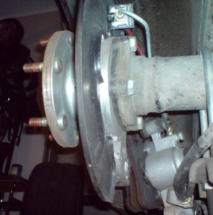

    Yea done,rear disc's, done electric water pump (Davis Craig) looks trick with the front of water pump chopped off an welded over. Lol .Also converted clutch to hydrolic ,used Willwood pull clutch slave cylinder an mounted little master cylinder up in the pedal box stainless braided line blabla ... Geting rid of me mag wheels gona go to steel wheels (black) want to tuffin it up a bit 17x9 & 17x10

    Hi thrill skier,the calipers I used for disc rear end are only available on the Australian ford falcon mid 90's era ,they are good for disc brake conversions,being alloy an have hand brake incorporated in the one unit.they are commonly put into jeep cherokee's over here. So yea not really an option for you guys in the US. If I was going to do that upgrade again I would just use a mitsi diff that already had disc brake on it, like a diff you guys have in ya Montero (NZ Pajero) that way the diff is set up with coils ,panard bar mounts,and mount for the big mounting arm that goes from chassis to diff (on both sides I.e left & right) then no need for expensive four link arms.

    Ford Falcon disc brake setup on Mighty max
    this is some pic's I took when I did conversion

    get a 2nd gen montero rear - it is like what Kiwi is talking about. I have one sitting complete with all arms, panhard rod, driveshaft and brackets - need to find higher gears (lower numerically) to replace the 4.63s in it now. Paid 200 for all of it - its a heavy beast as well. It is a 9" rear end, supposedly a copy of a ford 9" with 31 spline axles, and stronger that a ford to boot. In the late 90's, they went to independant axles - way more expensive to buy and may not be as durable. Some late 91 4door montero SR (top of the line, not the sport) had disc brake rears with leafs. Some Montero sports also had leaf sprung disc brake rears, but are real hard to find.
