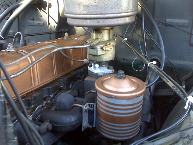

    The vaporization of fuel, combined with the expansion of air as it flows through the carburetor, causes a sudden cooling of the mixture. The temperature of the air passing through the carburetor may drop significantly within a fraction of a second. Water vapor in the air is “squeezed out” by this cooling and, if the temperature in the carburetor reaches 0° C (32° F) or below, the moisture will be deposited as frost or ice inside the carburetor passages. Even a slight accumulation of this deposit will reduce power and may lead to complete engine failure, particularly when the throttle is partly or fully closed.

    Camoit, your illustration shows a 1950's ford truck 1 barrel carb to a "log" intake & exhaust. The exhaust manifold is IN BETWEEN the intake runners!! Those runners would be waaay hotter than the 190 thermostat controlled temps, INSURING no way to ice..IMHO
