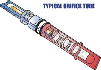

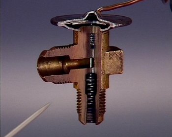

    OK so it will get cool just not cold. If you converted to 134A then you need a different Orifice tube. The gas runs at a different pressure. The TXV or thermal expansion valve works the same as the orifice tube. Just it controls the flow of liquid, not just blowing it through a hole.
    IDK if the 95 has the orifice tube or a TXV. If it has the TXV then you will see it in the high side line at the firewall. The orifice tube is inside the high side liquid line and just looks like it connects directly up to the evaporator.

    TXV
    Beware of the propane R12 conversion refrigerant - it is highly flammable and now illegal in the US. Better to use the R134 with ester oil and change the expansion valve for one compatible with R134A
