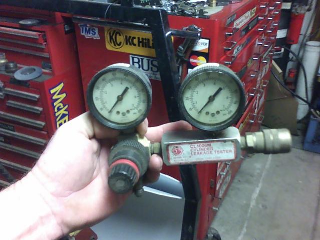

    So what you are saying on the last "wet" test your compression was: 160-109-108-130
    If that was the wet test then the 2 low ones may be swapping compression gas between the cylinders from a bad head gasket. If you do a CLT, (compression Leek Test) you can find where the air is going. You will need a compressor and your ear. With air going into the cylinder you listen and feel around the intake. tail pipe and valve cover. It will be coming out some where. You will here it or feel it.

    Never heard of that test, will try it.Have a cleaner/blower nozzle will feed that into the compression tester hose, screw it into the spark plug hole, inject cylinder with air.
