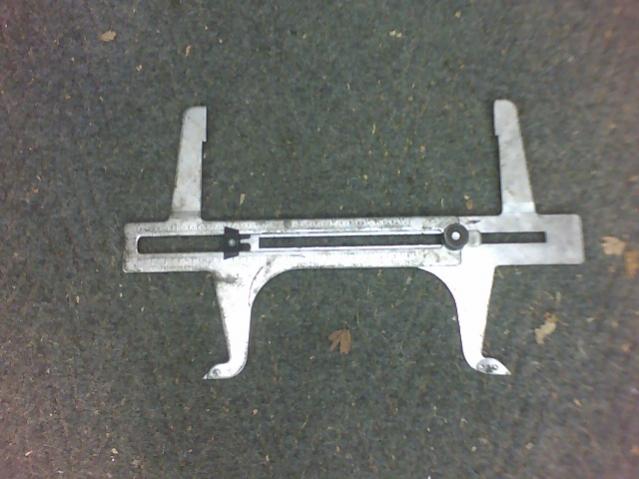

    First adjust the rear brakes. That will make a big difference. I would guess you changed the shoes while you were in there. Use a safe set tool. Then you can adjust the cables. If you can't get enough adjustment out of it. You can have California Push Pull or a local shop re work the cable for you. There is a link to them in the link section.
    Safe Set Tool.
    Safe Set Tool.

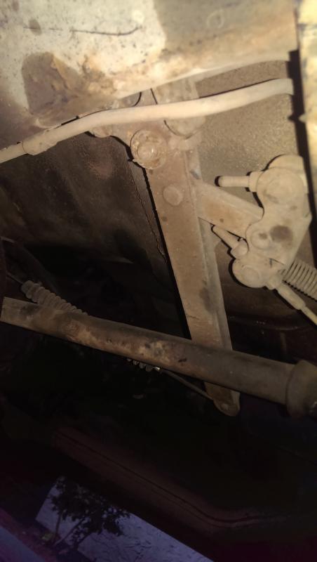

    Fantastic. I'll look into it. I peeked under the car and found this little assembly, I assume this is where I adjust cables?
    3,775
    Yep there are a couple of places, just fallow the cables.
