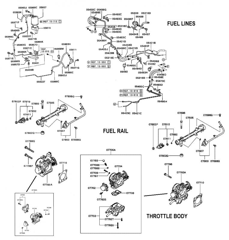

    The fuel pressure need to be checked before or after the fuel regulator? or does it matter. I would think after the regulator.
    Anyway...here is your entire fuel system.
    Click images to enlarge
