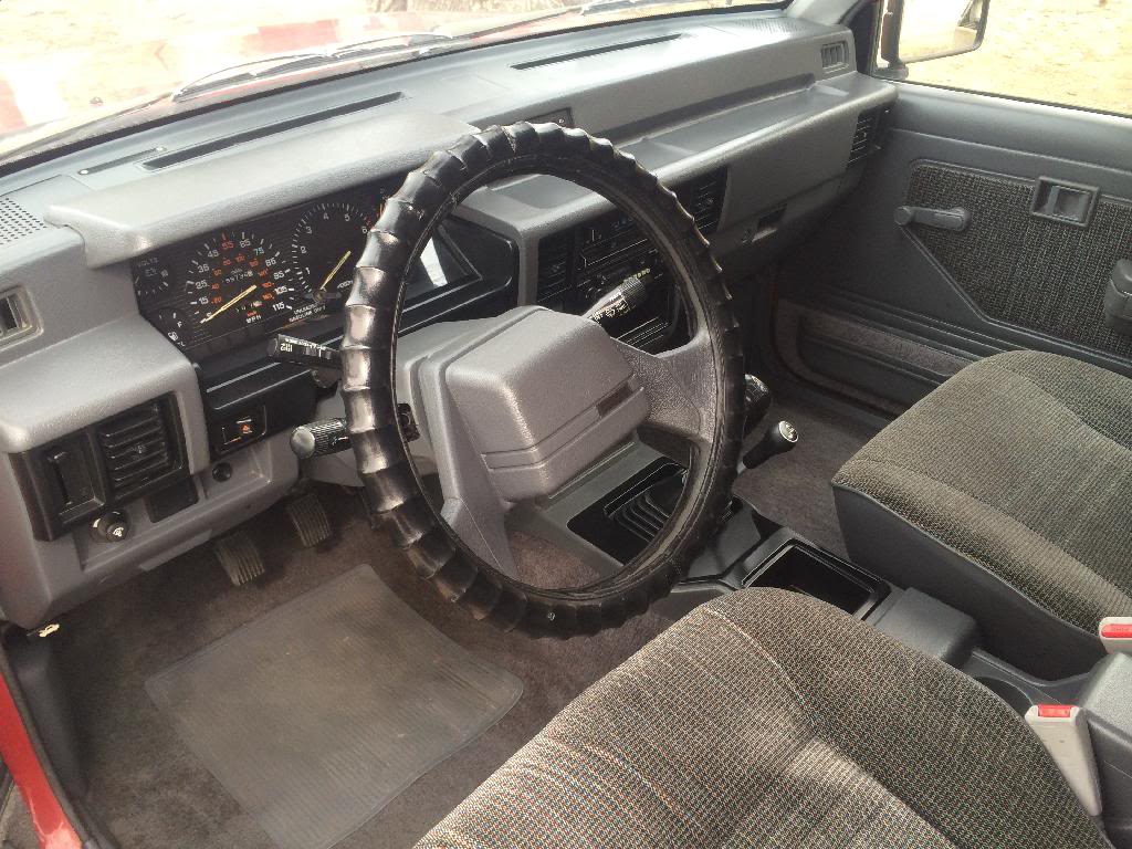

its coming from a 1990 and this is what im talking about, this is for a 4x2 but if i remove the black bezel thing will it fit my 4x4? sorry about the watermark it was the best picture i could find. console.jpg
I see, you don't want to purchase a part and find out it won't fit if I'm correct.

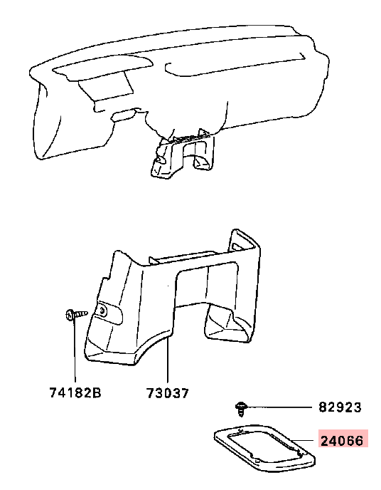

These are the 4WD console parts, sorry I have no measurements only parts numbers.
These are the 2WD parts. You maybe able to compare part numbers but they show no opening measurements.
click images to enlarge
awesome, thanks it looks to be the same part

This perticular center console (picured above in the first few posts) will not work for your 4wd truck, the opening is too small and removing the black plastic trim will not work. you need to get a 4wd console (pictured below) from a second gen. They are VERY hard to find and rare. Good luck.
