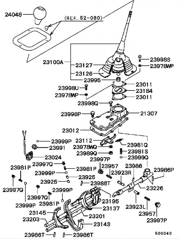

    Here are the diagrams of parts for your transmission
    Your shifter parts

    This is yes and no, the km145 does not have the removable top plate that the shifter bolts to and uses a square four bolt pattern to mount the shifter. The actually mounting surface is part of the t-case.
    Your shifter parts
