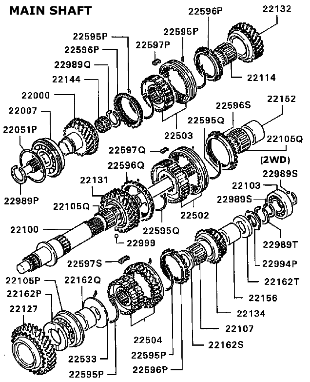

    See below

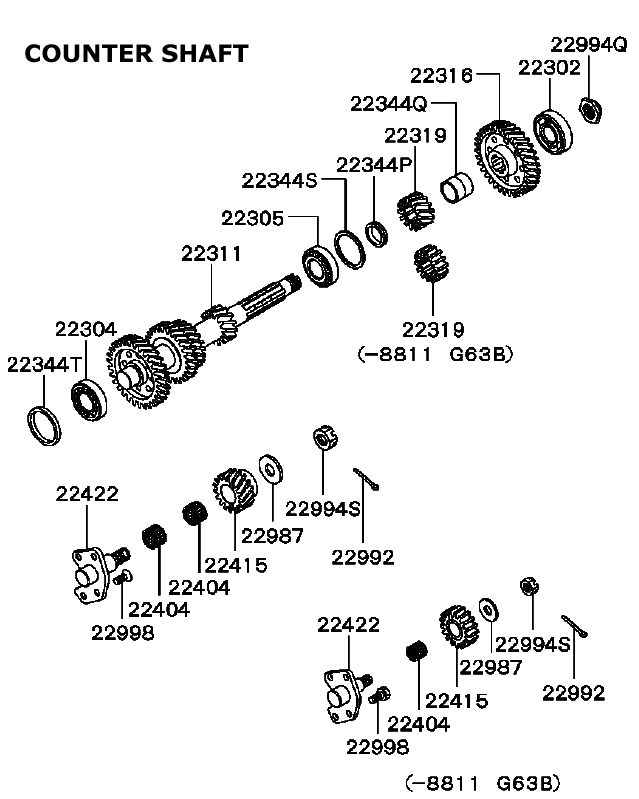

    Here are the diagrams of parts for your transmission
    Your shifter parts

    Your shifter parts
