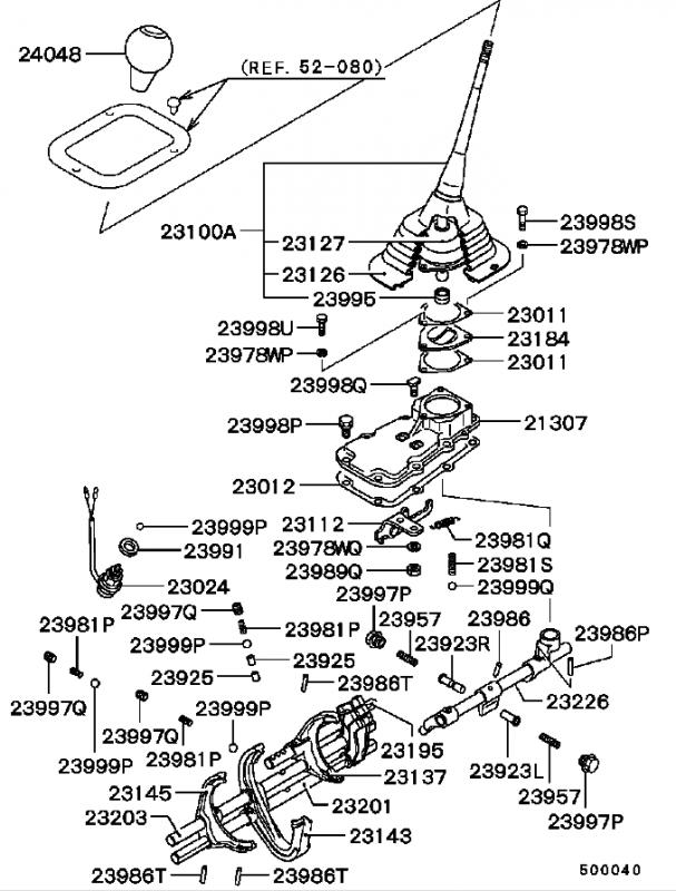

    so the bolts were tight, i pulled the shifter.... here is where i am stuck. the plastic or neopreme on the end of the shifter was okay. but how the heck do i get the shifter back into the linkage or cup?! it just flopped around .... could not seem to fit back
    the plastic bushing on the end of the shifter should just drop back into the piece on the shifter rail unless something is really bent or worn. BTW, 4th gear on a km145 is straight through with no gear engagement, so if it isn't working, there may be bent forks or shift linkage causing the problem. I had a friend whose sons d50 got stuck in 2 gears, so he slamed the shifter so hard, he shattered the main bearings in the case.

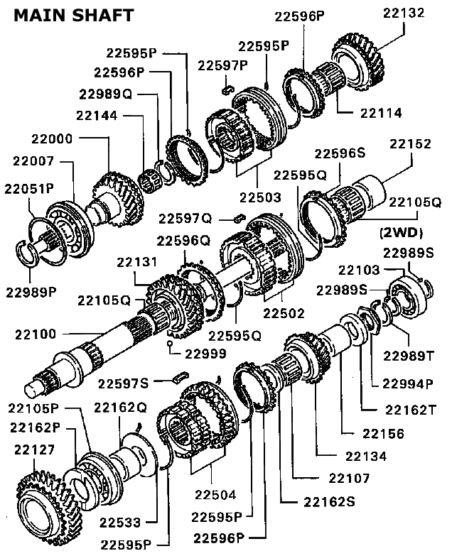

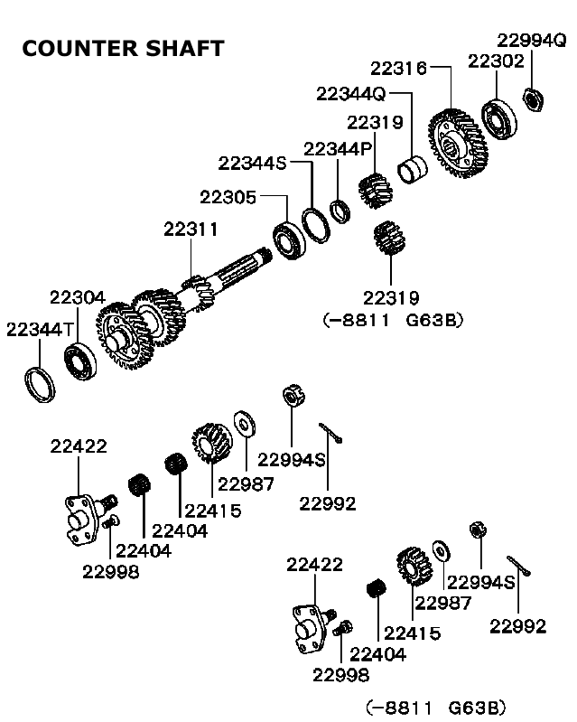

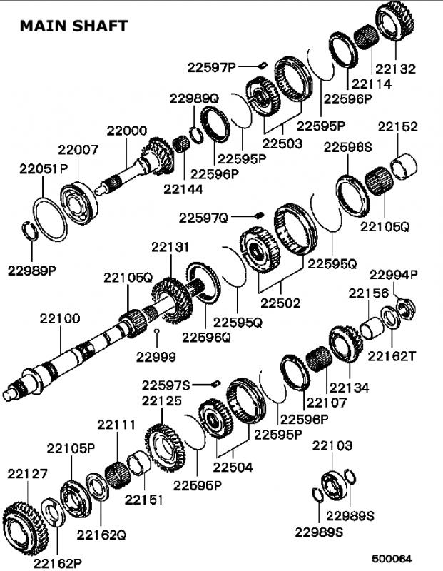

    Here are the diagrams of parts for your transmission
    Your shifter parts

    This is yes and no, the km145 does not have the removable top plate that the shifter bolts to and uses a square four bolt pattern to mount the shifter. The actually mounting surface is part of the t-case.
    Your shifter parts
    See below
