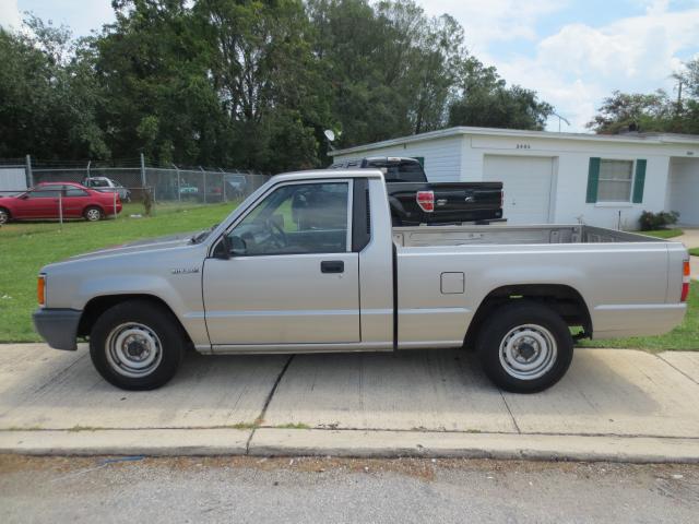

    Well not really building anything yet, but just trying to keep all my updates in one place. I bought the truck last year (1995 M/M) with 89,000 miles on it, body/paint looked great, new tires, all smiles until the first rain storm. Well I though the windshield was leaking only to find the upper trough was rusted through letting water into the interior. The front end had a few squeaks and pops, so on a closer look found the idler arm was crap and was in need of lower control arm bushings.

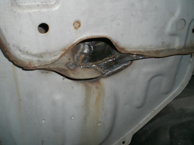

    The left side was a different story, a bit harder to get to but not too bad, after new metal was welded in place, POR 15 was then added and topped off with seam sealer.
