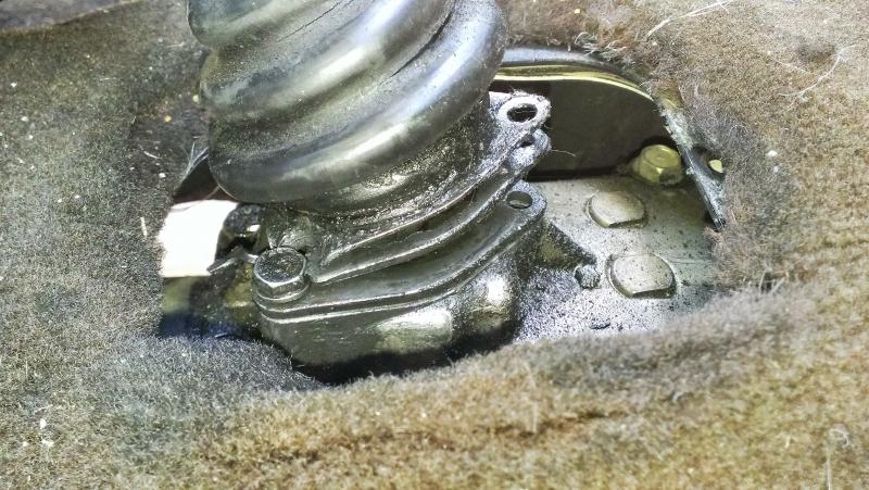

    Just picked up an 87 MM 5spd w/ a 89 2.6l d50 engine an the shift lever mount just broke been lookind around an hard to find another is there anything outside of a mm or 50 that has a swappable shifter? I'd love to find a longer one like rat rod style. Maybe a mod I could due any info helps thanks

    Triangle pattern if that helps

    Once I pulled it I realized the ears broke an no fixing it

    Hmm, looks like a drill and re-tab the T-case for a 7/16 bolt?

    Looks like your missing a bolt from the picture. Maybe new bolt, and large washer around the other 2 bolts to hold it down? Don't forget the gaskets above and below the shifter spacer or you'll leak gear oil.
    the housing on the tailshaft that the shifter bolts to is a separate piece that unbolts from the tailshaft. if its broken it can be replaced.

    Well if that top plate is broke I got like 2 spares that do me no good, and a spare shifter.
