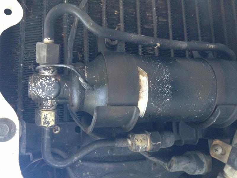

One more question. I bought a new receiver drier, as i was installing it. I seem one side is a 5/8 (left) and the other side 9/16 right. On the old drier both sides are 9/16 image.jpg
you need the drier with the right fittings - don't think they have adaptors for those...
