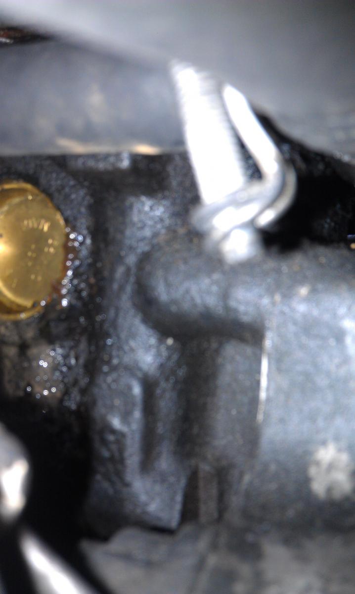

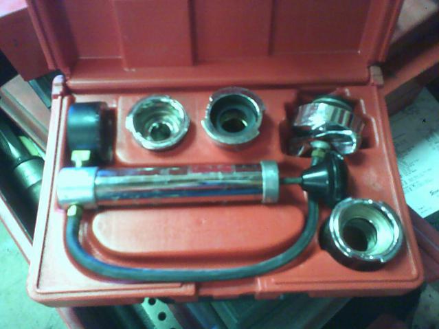

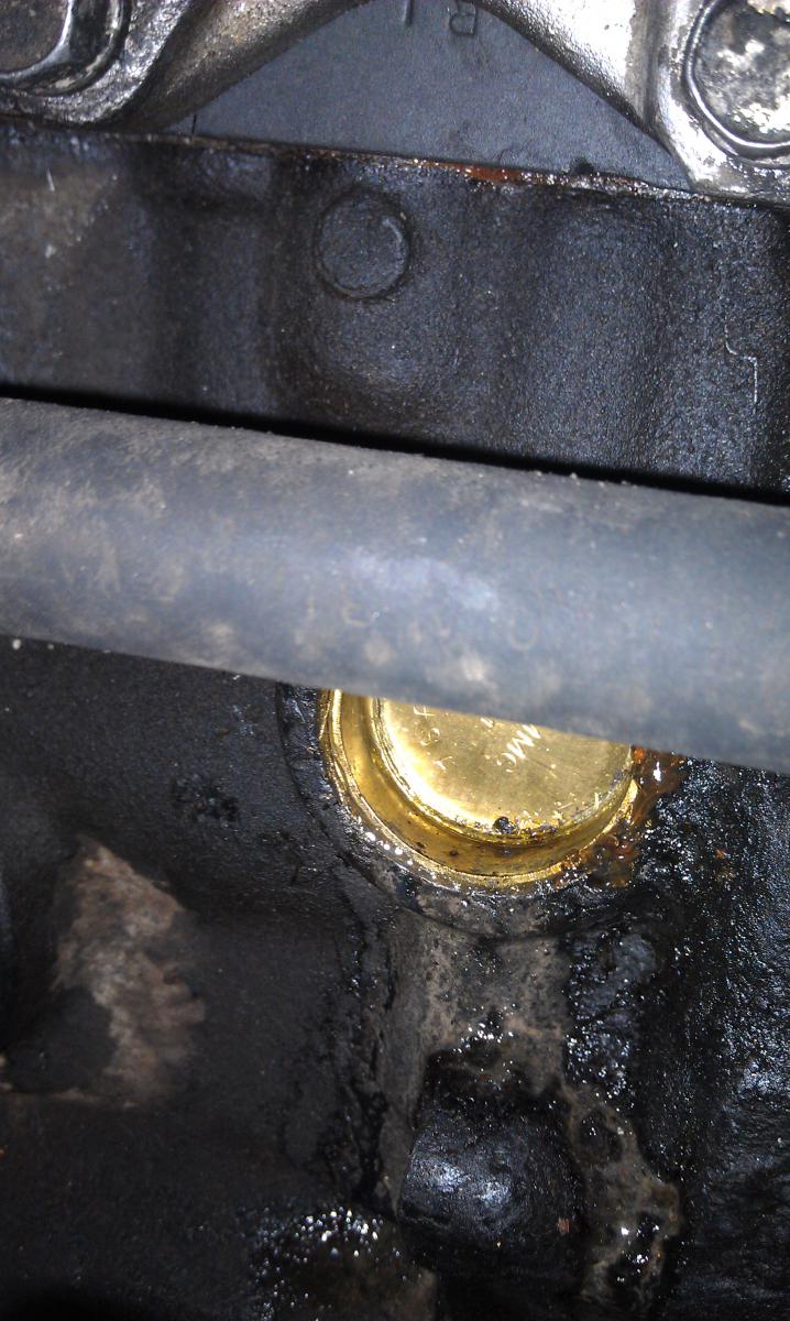

    I am also having this problem, so I would like to bump it up. My oil was same milky color as mentioned above and it was everywhere in the valve cover and in the oil pan. I did a block leak test, which consisted of putting a special liquid in a tube and putting the tube into the radiator cap opening to see if there were combustion gasses in the cooling system which came up negative. I did a pressure test with the kit pictured above and I seen water dripping somewhere and it slowly leaked pressure. This is where I believe the leak came from:IMAG0899.jpgIMAG0900.jpg

    For anyone who may be having the same problems, I discovered the issue. first I tried replacing both the intake and head gaskets, but it did not fix the problem. A few days later I had water in the oil again. But the funny thing is I pressure tested the cooling system immediately after replacing the intake and head gaskets and it showed no leakage in the cooling system. Little did I know I had pressurized it while the engine was cold. So after rediscovering water in my oil I drove it until it was hot and as I opened the oil cap, the cap was milky white, but also I could hear a hissing/bubbling sound coming from under the valve cover. When the truck cooled down it went away. So I pressure tested the cooling system while the engine was hot and sure enough I got a hissing/ bubbling sound. I turned the engine over by hand to see if the leak changed sounds with valve and piston movement but it did not. I concluded that head was most likely cracked due to a previous overheat when the thermostat failed and the reason for the leak only when hot is probably the expansion of a hair line crack somewhere in the head. So I went to the junk yard, pulled a 4G64 head with 131,000 miles on it for $92 and finished putting it on today. So far so good, if anything comes up I will post again.
