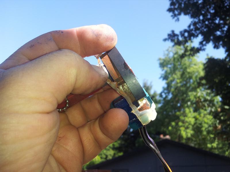

    No fire all the sudden and no doubt I found the problem, well one more.
    MSD knows about the problem, they're adding a coating over the triggers now. It's caused by Ionized air they say, understandable since they do carry a substantial arc. They recommend drilling two 3/8" holes at rotor height in 180* opposition so the rotor will act like a fan. I say seal it and purge it with CO2 or Argon, but how? The distributor, cap and rotor looks like shit with about 500 miles on it, I never start it and shut it off unless it's "completely" warmed up.
    After cleaning I did get good numbers and the magnetic trigger will fire the MSD off on the counter but while turning over it fails, no spark. They say clear coat the trigger fingers and pickup to protect them, but people are also are painting them. I ordered a new pick up.

    Why the silicone?
    MSD suggests the silicone to be re applied, obviously it doesn't protect the steel used. (They also use stainless screws and steel nuts)
    QUESTION: Why not use a light coat of dielectric grease but not between the magnet and steel or ends of reluctor and pickup, would it not do the even better job of protecting the circuit from moisture and air or will it ground it out?
    I didn't do it, I'm just asking. lol I've read up on it.
    They may use the silicone rtv as an anti - vibration cushion and to position the pickup rather than just to insulate it from ground. Never had to put in the pickup like that so I am not positive on this
    The silicone is a glue that keeps things from moving after you set the gap. I'm clear coating the spar MSD I have just in case I go back to it. After the short time of running it has already started to corrode. By adding the holes in the rotor it helps to break up the air. I want to switch over to Crane Cams But they don't make anything for the V6

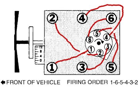

    Where do you have # 1 pointing? What direction is the rotor pointing on TDC # 1 ? I have yet to find the correct place. Some show front, some to the rear, some to the right side.

    My #1 in the top pic is #5 the bottom pic #6. If I'm not mistaken on chevy you can turn the oil pump if you have a screw driver that is as long as the distributor. It's been so long, but I swear you can turn the oil pump. I'll be dropping my back in here shortly, it should be pointing @ #1.
    I think what MSD did on these PRO "BILLET is crap, they blued the top, they could have blued at the least the reluctor.
    Clear coat is still paint, just no pigment.
    I read they are now adding a coating to the new distributors. As far the silicone if you look at the reluctor in the pic the rust is under the silicone, I applied very little effort to get it off.

    Yep thats where mine points. The marine left hand drive #1 is where 6 is but it turns the same direction.
