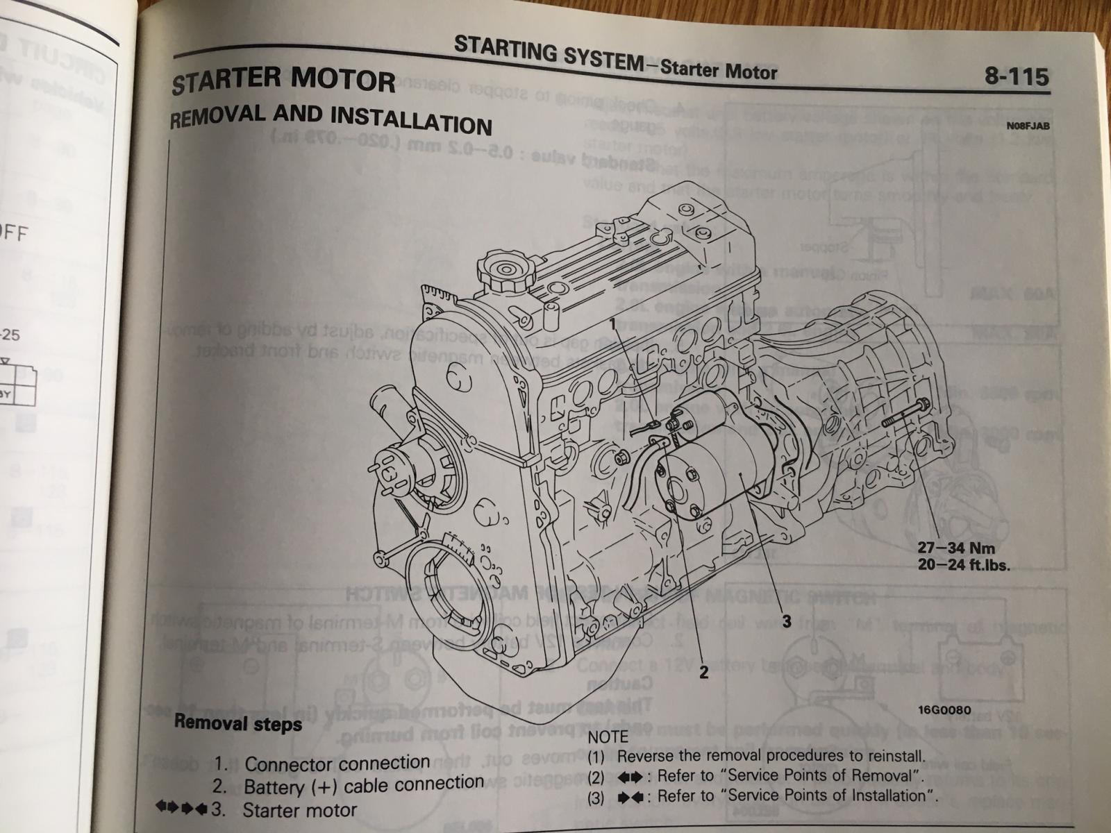

    Not sure if this is the bolt you are asking about, but this one here is the only one with a torque specification in the starter seccion of the service manual ('87).
    03-06-2018
    668
    Tucson, AZ USA
    Yep, that's the one! Looks like my guess was spot-on.
