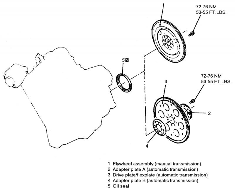

    I have a rough flywheel with a good ring gear and a good flywheel
    With a bad ring gear. I don't see how it comes apart.
    Do all ram 50 flywheels have replaceable ring gears?
    How do I get it off?
    Thanks
    Zz
