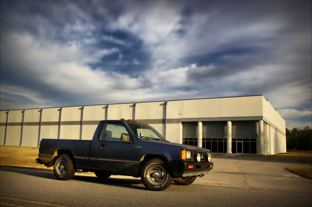

    My name's Ryan, I'm from SC, and this is my 89 Mighty Max 2.0 AT that I picked up for free. A tuneup and she was running with 59k original miles.
    And this is how she looks now:
    List of repairs and mods:
    Full tuneup
    Pacer wheels and Mastercraft Avenger GT 225/70R14 tires
    Repainted front bumper
    JVC headunit and 4" Memphis Street Edge dash speakers
    Hella 500 driving lights
    modified turn signals in bumper to light up with parking lights (much better looking)
    painted Mitsu. logo on grille
    added clearance markers

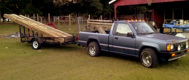

    And here she earning her keep:

    nice little truck man...putting it to work huh..

    I remember seeing your truck on the old site. It was what inspired me to put on my fog lights, mounted slightly differently though. Like your idea of wiring the turn signals and parking lights together. I've been wanting to do something similar to that myself. It's looking good, keep up the great work man, and welcome back!

    A little bit of clarification , blindeyed... I didn't wire the lights together, I added a twist wedge base bulb socket to each turn signal housing. If I just wired the parking lights to the turn signals, when I had my lights on the turn signals would not flash. Make sure to use a bulb that is dimmer than the turn signal bulb so the flash is noticeable.
