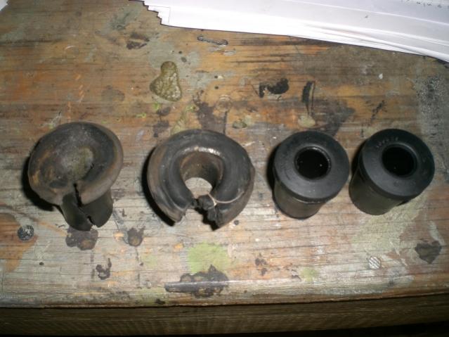

    I just rebuilt my front end...here's why it squeaks

    That's exactly what my lower arm bushings looked like, at least what I could see from underneath. So do they come in sets of 2 or do I need 4? Because the 2wd images only show one of the bushings you have to the right

    I purchased mine from Rock Auto, and got the Moog brand, 2 bushings in one box (front and rear), so you need a quantity of 2
    http://www.rockauto.com/catalog/more...816&cc=1207022 there only $5 and change
