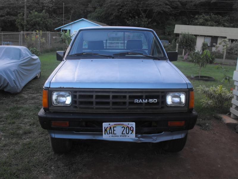

    Pictures of the 1987 Ram 50
    Aloha
    Here's the new pickup.

    I'm on Oahu. Nice looking truck. Could take a mallot to the front valence. The rear bumper, it would look cleaner without the bumper but you could always make a custom racket to hold different bumpers. A few guys on here have had luck with the Toyota chrome bumper inthe front, and can't be too hard for the rear. I won't name any names, but they can jump in anytime. Try to adjust the cable so the threaded section sticks further and further out of the firewall. Sounds like improper adjustment causing enguagment issues. Still a little confused on how hard the pedal is to press down. Try to give us a picture of the cable as it sits now. Maybe a few pics of the firewall and the a few more at the trans connection.
