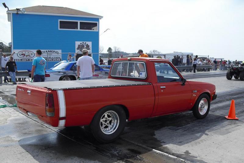

    I have one with a stroker 340 in it and I have a 9 in. ford rear in it. My trans tunnel is cut out and a fabricated one in it.CIMG0081.jpg
    07-27-2011
    263
    Nyssa, Or
    1982 Dodge Power Ram 50
    So what's run.
    "There is no darkness only lack of light; There is no cold only lack of heat; There is no peace only lack of war." YODA
    Sometimes, it pays to be subtle, as a hammer to the forehead.
    07-02-2013
    35
    Alabama
    Dodge V8
    Best so far is 6.34,1.34 60ft. @ 108 mph in the 1/8 mile.
