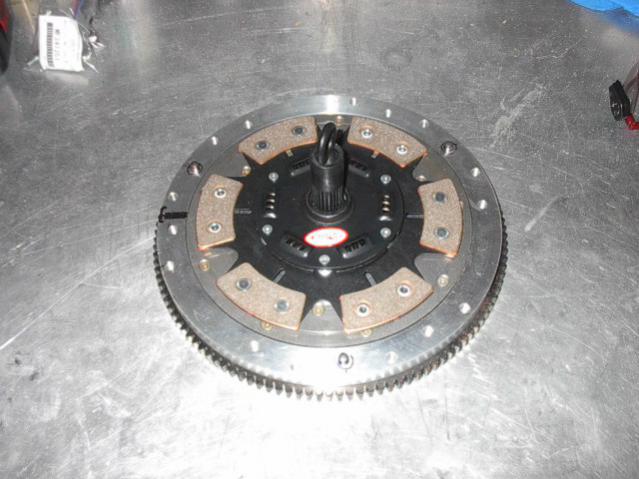

    Puck clutches aren't very nice for the Street, they engage very harshly, they hold well, but don't drive well. Also the material is hard and grainy, which is great for grabbing but not nice to to the pressure Plate and Flywheel.

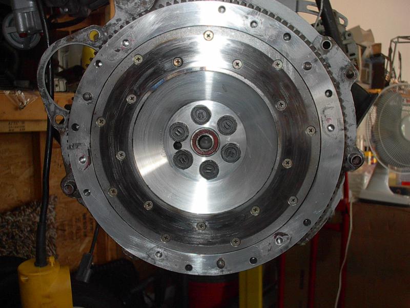

    I used a 6 puck unit and overran it's capabilities and here is what happened.
    in the beginning
    the aftermath
