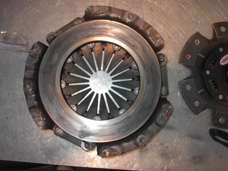

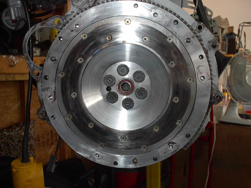

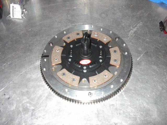

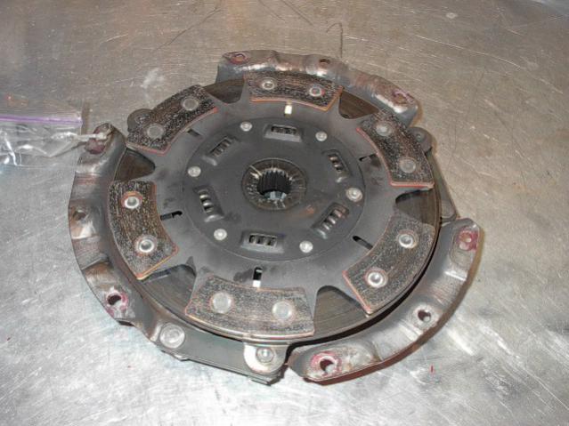

    I used a 6 puck unit and overran it's capabilities and here is what happened.
    in the beginning
    the aftermath
