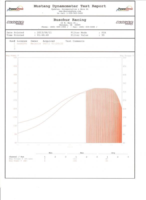

    Had some fun with the dyno, been needing a re-tune for boost increase (30PSI) and change of fuel to VP C-16 (117 octane).
    The truck was having problems going lean at the top end. After a few pulls, Buschur was scratching his head until he looked at the injector duty cycle, 104%, so the old 880CC injectors were replaced with 1200CC units, duty cycle down to 64% AFR much more consistent.
    The truck is still having a problem above 6500RPM, put in a new set of Iridium Plugs gapped at.018, better, but still something there.
    Theory is the boost is blowing out the spark at high RPM. headed out to the junkyard for a new coil this weekend. We'll see what happens over the July 4th weekend.
    In this state the truck made 335 HP and 312 ft/lbs Torque, that's Mustang Dyno Numbers, not DynoJet.

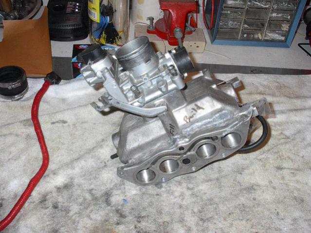

    Aftermarket coil pack? what's that? Actually I've looked, nothing out there. the recommendation is a MSD DIS-2 box... $600. I'm thinking the old coil I have is getting weak. Camoit, intake is heavily modified, no runners, Plenum. At those RPM's and my cam profile (284 degrees) and advance there is a lot of air moving.

    Maybe it's to much turbulence with out any runners? Just tossing that out there. At that RPM the volume of air is about 5000 gallon. Thats sucking a Hot Tub dry every minute. Thats not very green now is it? Even with 30 PSI of boost you need to think about the wave form that is created by the stopping of flow. You need to build a mock up engine top out of clear plastic. So you can run it like a wind tunnel and work out the kinks of flow. Get a nice laminar flow running through it. But then again you hold a record so what do I know. But if you want to make it have lots of suspension travel and go 165+ MPH then I'm your guy.
