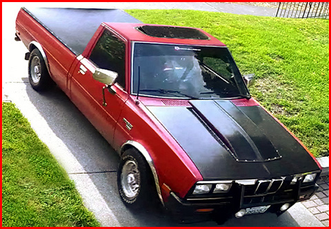

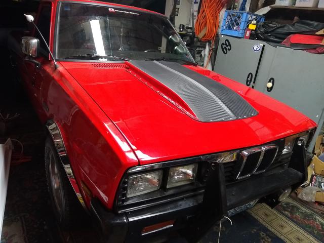

  17. #242
    I thought I would post some pics of the truck as it sits now, painted, new bed cover, and other work. Putting a stereo system in new now as well.
    Finally also got the hood and cowling to be same color pretty much with a carbon fiber wrap on the center area. Still runs incredible and having fun when not upgrading items.
    Can't believe I started this thread in 2013, 8 years ago. Been a great time here at the forum for sure.
