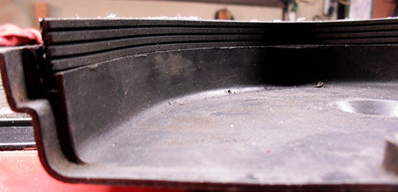

    Well tonight was a good night and I got a ton of work done. I completed the High-Rise Weber adapter and it came out nicely.
    I then installed the new adjustable cam sprocket.
    I used the same sprocket bolt, but I had to change the washer to a thinner one so I could catch more threads on the bolt. I torqued the bolt to 70lbs which it has a max of 72lbs. The sprocket fits very tight to tolerance with the timing cover. The bottom cover was ok, but very close. The top cover I had to shave a couple of millimeters off the bottom. I wanted to stick with the cover on the truck and the only way to do this is by spacing it out about 5 millimeters. So this is what I did to accomplish this.
    The cover has a small rubber seal inside the rim of it. I decided that this would be the way to allow more room for the new wider sprocket. So I went to the auto parts store and purchase the shortest serpentine fan belt they had. The owner took me to the back and we looked through the belts and I found one I thought would do the job. I had to cut the belt to a proper size in length and then cut one rib off the serpentine grooves for the correct distance over the sprocket. I then pushed the belt into the existing groove in the cover after removing the small original rubber seal. This fit perfectly and was also sturdy enough to maintain the covers distance from rubbing the new sprocket. This also sealed the cover from inhaling dirt and road dust into the timing cover area. For the bottom portion of the cover seal, I used a piece of sticky one side rubber door seal and attached it to the lower timing cover to seal off the upper cover lower end. It all worked great and the sprocket is free from rubbing.
    We will keep an eye on the install for a few days to make sure nothing freaky happens that might happen. All and all it went together pretty nicely and should not cause a problem. We will also make some time adjusting later after it is found to be secure enough.
