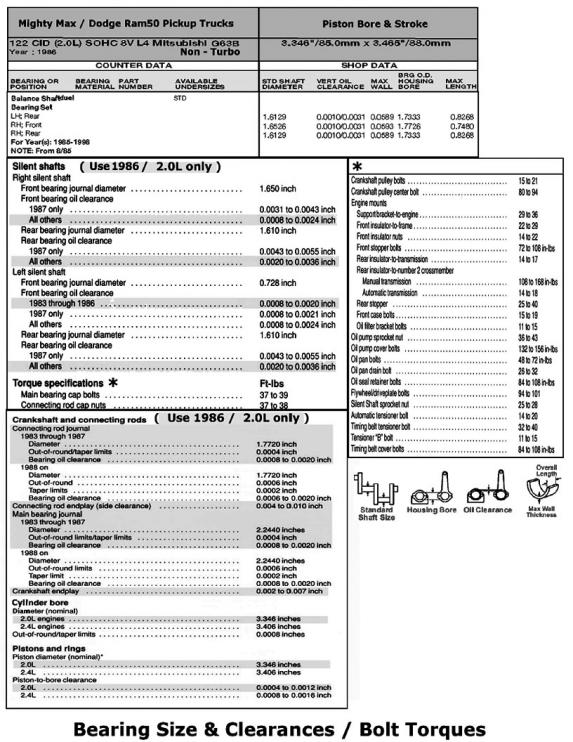

    I also have these great documents to help me get things right also.
    Download Your Own Copy of This Specs Page
    Clearance & Torques.zip
    Clevite has a basic formula to figure out oil clearance that they show in a great catalog available for download. It show failure diagnosing and much more. Here is a section on proper clearance.

    Now if I am wrong someone correct me here because I am no pro at this clearance test stuff and I want to get correct. Here are the numbers...
    The torque on the main bearing caps was 37-39 ft. lbs.
    The required oil clearance for the main bearings is...
    0.0008in. to 0.0020in. which = 0.02mm to 0.05mm
    My test with standard size bearings which shows in the photos above displays an excessive clearance by at least...
    0.025mm My maximum clearance should of squashed the gauge to the .051
    In the photos it shows a little less then the 70's mark (0.070's mm) on the plastic gauge packaging, so to decrease the oil clearance to
    at least the 0.05mm maximum that is my required oil clearance I would need the 0.025mm size bearing like I should of got. If I am not
    mistaken and correct me if I am, the 025mm bearing is the same as the 010 in. bearing. To be exact the 010 comes out to be 0984252 in.
    So, the big question I have is...are my figures correct? If I got the 025 bearings, would these bearings decrease my oil clearance to a
    closer and compatible oil clearance of 0.0008in. to 0.0020in. which = 0.02mm to 0.05mm range?
