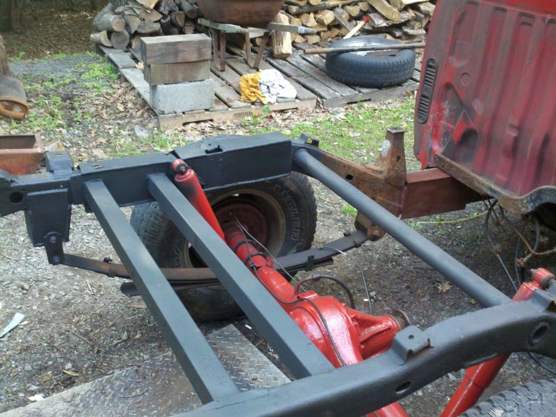

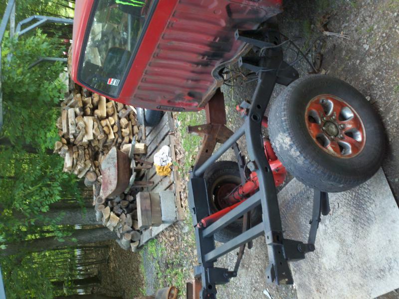

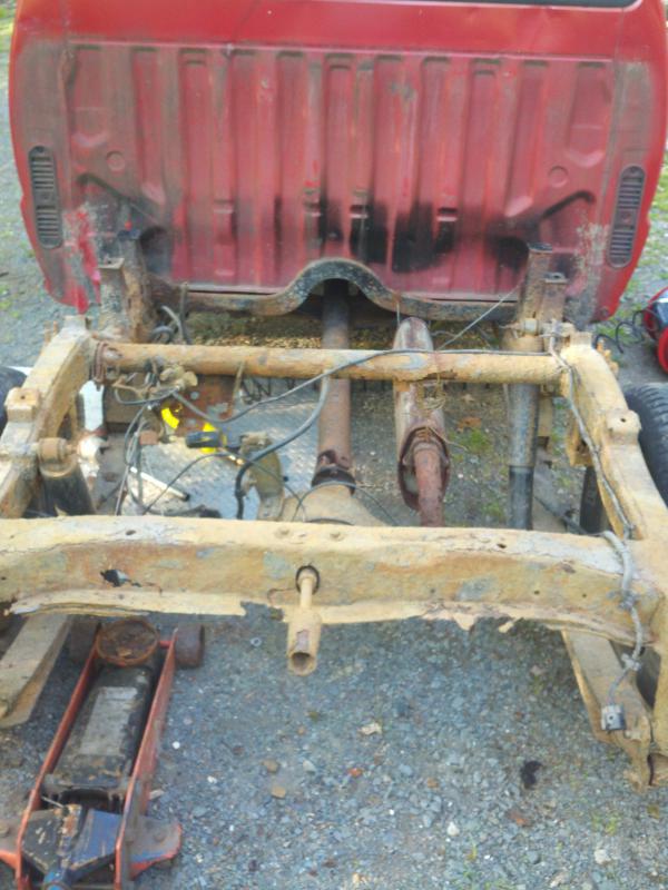

    boxed out shackle mounts... ready to drill new hole and sleave when i figure out how low i can go.... im going to use lowering blocks i think and maybe remove the middle spring... if i still wanna go lower im just going to do what i stated above. new center crossmember and new rear crossmembers i wanted it stiff.. frame had 2 holes so i patched it fully boxed 1/4 plate. new rear brake shoes and all new parts. new u-joints. new fuel lines and brake lines new spring bushings. i still have some fab work to do with the tank mounts and stuff like that. next im taking the cab off so i can clean up the frame and run the fuel/brake lines easier. then on to the motor im still researching what is the easiest motor to drop in this creme puff i want a 4cyl. . turbo. it is 4x4. i just want it to move. and i will be spraying the truck something along the lines of gunmetal gray. what you guys think of the rear so far?

    You started with a 4x frame to slam? A 2x frame rear gives you a 3" drop stock. But I see your welding is already done.

    Well I got this truck for 250 when I took the bed off the frame was in bad shape I tried to find a new frame but I live in the middle of nowhere and the junk yards didn't have any so I gotta work with what I got
