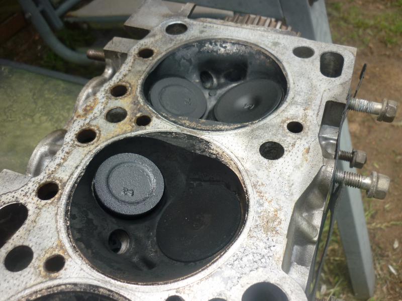

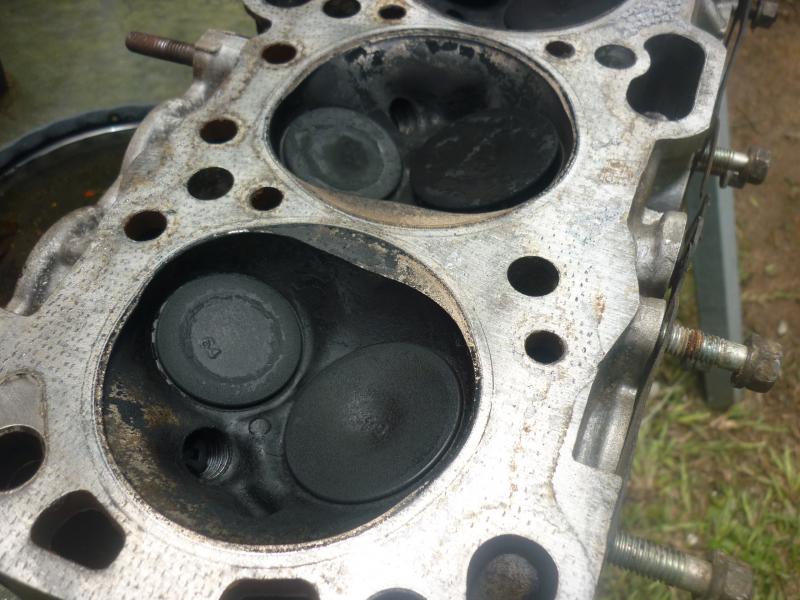

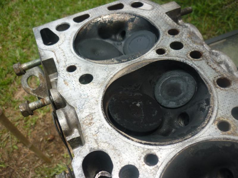

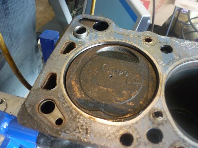

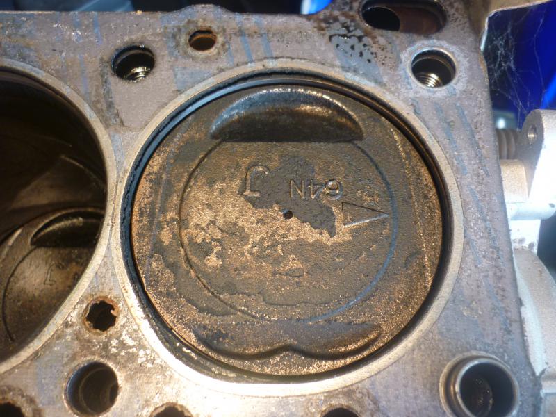

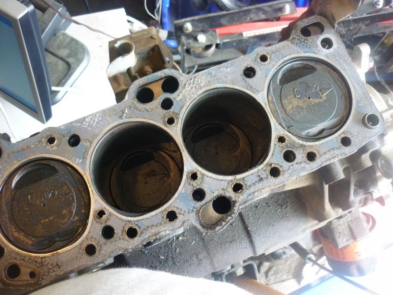

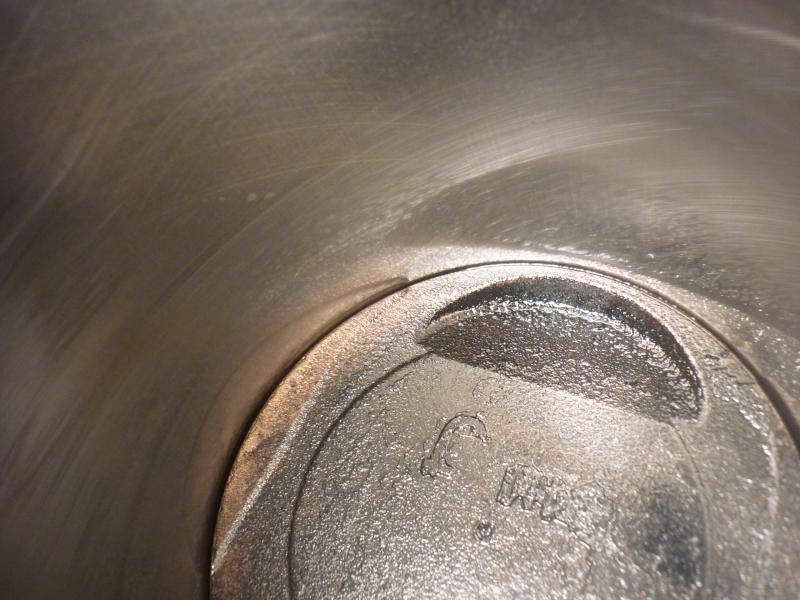

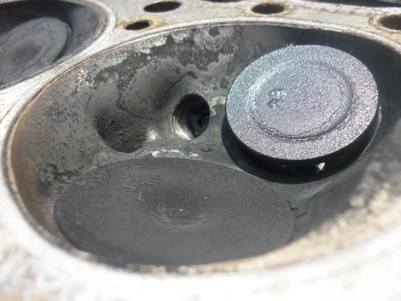

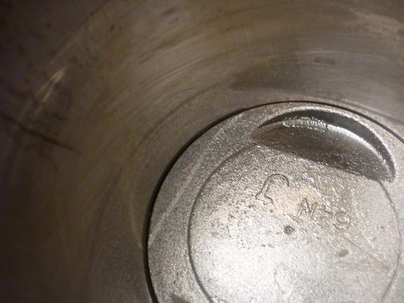

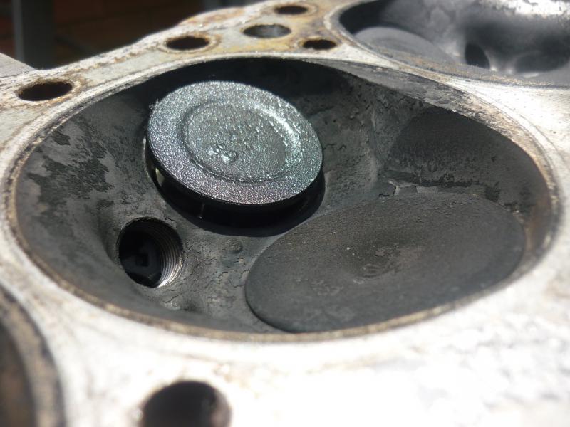

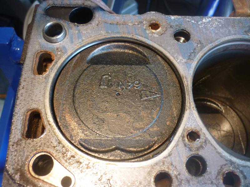

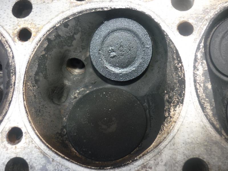

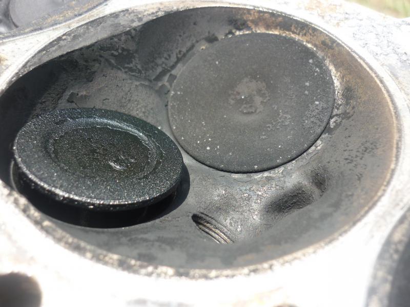

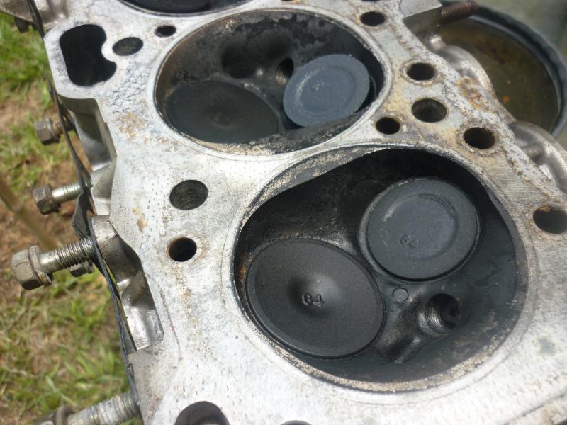

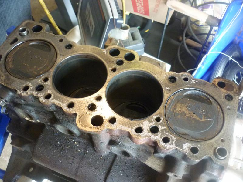

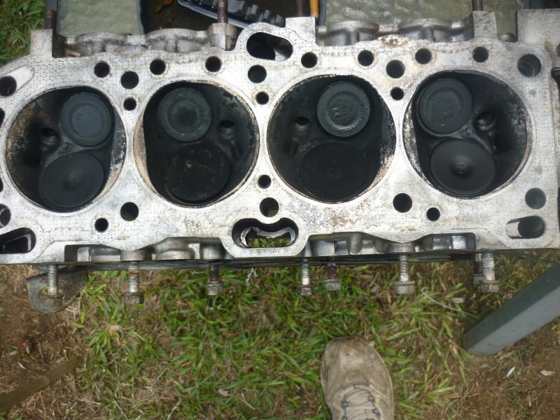

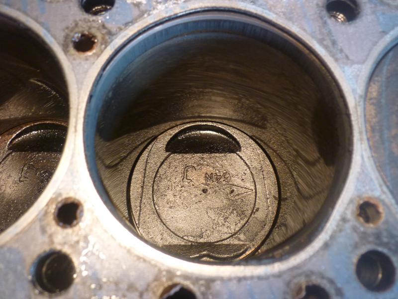

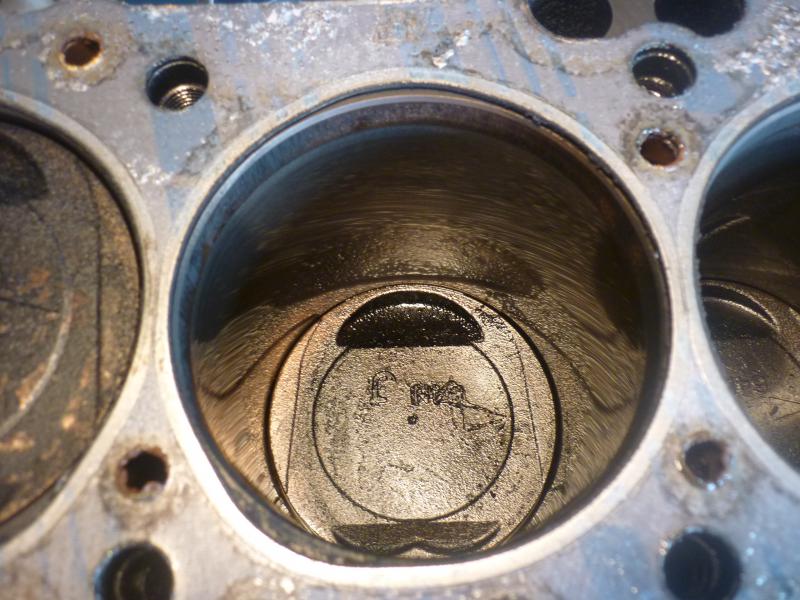

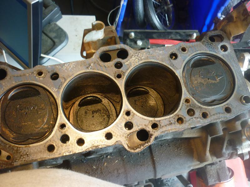

    Here are the pictures I promised:::::::::::::::::::::::::::::
    831
    From the Pic's it looks like the Valves in Cyl 2 and 3 are dirtier then 1 and 4, you might have a small crack in the head between the 2 and it's leaking coolant into the piston. If you take a real good look piston 2 and 3 are clean on top that means they are being washed with something either gas or coolant. Best thing to do is have the head checked for cracks and really inspect the head gasket to see if there was a leak from the water passage to the cyl's

    So, from the looks of the cylinder walls, it doesn't appear I have a ring issue. I'm hoping that having the head rebuilt/replaced may do the trick.
    I had some white smoke when I stomped the gas. Just a trickle of smoke when idling.
    Budgets very limited, so getting away with just head work would make my day.
    831
    White Smoke = Coolant, Black Smoke = Flooding, Gray/Blue Smoke = Burning Oil. So if you were seeing white its either a crack in the head, warped head or bad head gasket.

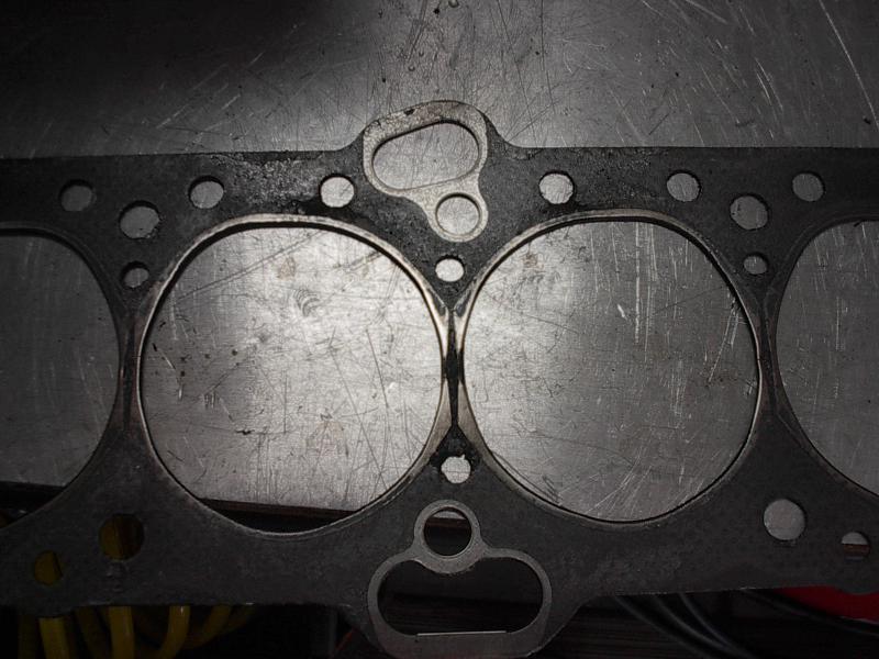

    yes, that would cause a leakdown failure, and the 2-3 junction is the likely place to get coolant also. That where my head gasket let go.

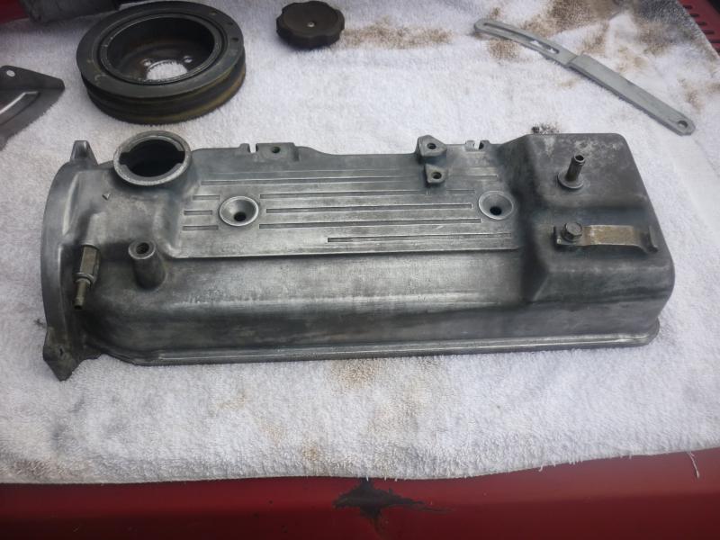

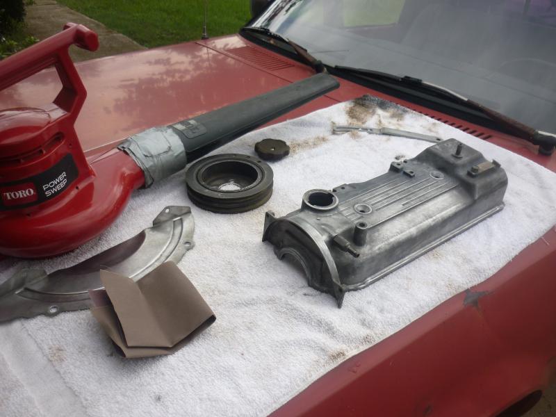

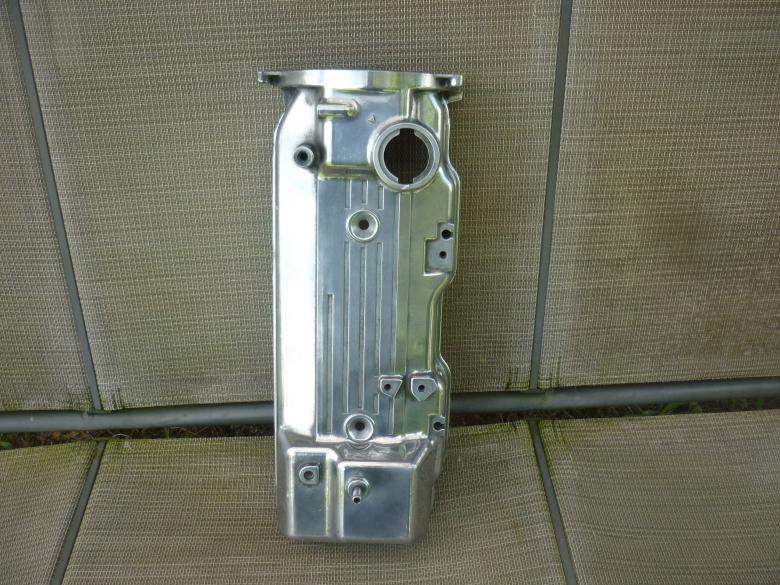

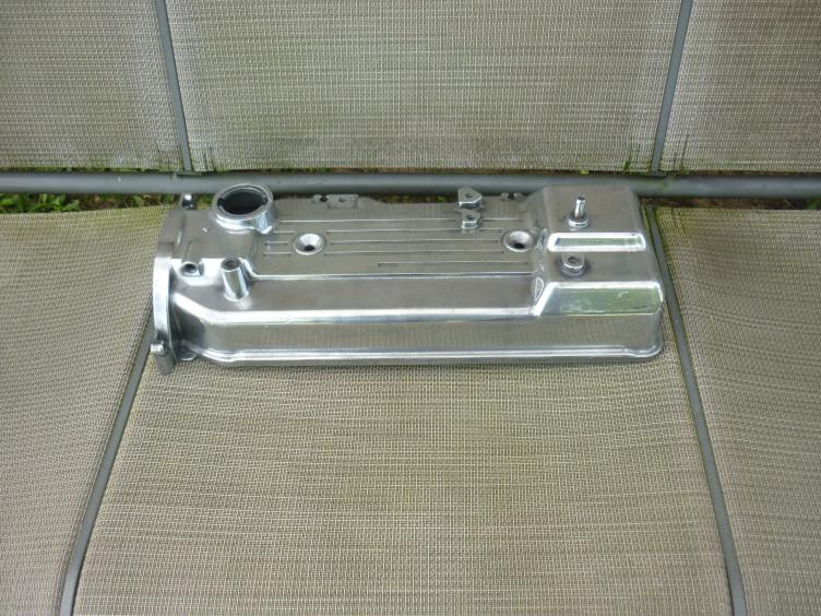

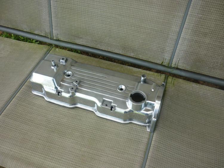

    Well, lack of funds has stalled any and all progress.......................................... ..so, I dabbled a little with the polishing equipment that I use for my bikes, and decided to see if I could do something constructive on the mighty max.
    Cleanup parts (1).jpgCleanup parts (2).jpgCleanup parts (7).jpgCleanup parts (9).jpgCleanup parts (14).jpg
