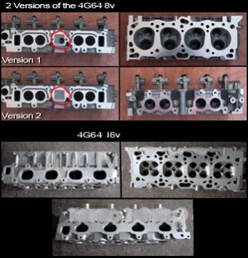

    okay so i have been wanting to boost my MM and have just been confused and driven crazy with the research and looking ive been doing. I really wanna keep the stock 2.4l block and not do a engine swap and here's were i get confused can i and should i run a gallant/eclipse 2.4l 16v head or 63 dohc head i think i would rather run sohc 16v. but if i were to do the swap what all would i need like the head, head cover, water pump, intake, computer, etc.... it would be a DD and not be over 10-12 psi so if you guys could just help me out give me some help and tips it would be much appreciated.
    Images showing 2 versions of 8v and the single 16v
