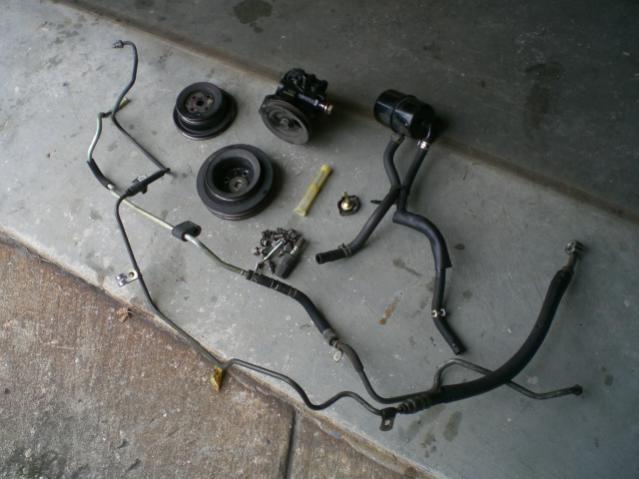

    powersteering.jpgWell today I made the trip to St. Pete to check out a 92 M/M with automatic. I knew with that option it had to have power steering. Well I was right, but when I approached I noticed the steering was already gone...DAMN! But I got all the other parts I need which as we know are harder to come by...I guess I scored then....YEAH! So with a 4 hour drive, 3/4 tank of gas and $92 later......I got this
