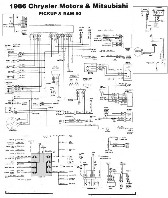

    I am doing some much needed work on an 86 Mits. MM and during thsi adventure the truck's starter has began to crank over while key is in the RUN position and stops cranking in the START positon. Accessories work and everything else seems ok.

    Now everything worked fine that was replaced above, but the truck is now cranking the starter over while in the run position. I tried another ignition harness in the steering column an it still cranks over in RUN and stops cranking in START positon. There is no burning fuses, lights are all working, starter sounds great when cranking and voltage gauge shows a normal drop while it spins. I have not moved any wires out of their normal position in ignition or in engine bay. Getting 12 volts to coil and starter, but not while in the START position. I have now bypassed the oil safety switch until problem is corrected, Ohm readings on the coil are in specs.
    I need to re-check the new alternators wire color code on the plugin behind alternator and make sure they are not reversed somehow, but it seems fine right now. I am just tracing my steps to see what possibly could of got crossed up.
    If you have had this happen, go ahead and chime in and let me know what you did to correct it.
    I may run some test leads from ignition switch to coil (hotwire) and starter and see if this corrects the problem, if it does then there is a wire fouled up wire somewhere. If it doesn't, I'm still at step one again. The ignition switch works in accessory, but soon as it clicks over to run, it eguages starter.
    This is a diagram below that best represents my wiring, though my smog is removed and the diagram also shows extra items that are not installed on my truck.
    I have a 5 speed as well.

    Check your black / yellow wire out of the IGN switch. That'll tell you if it's a bad switch or a harness issue. I've never heard of anything causing this but a bad IGN switch or harness/connector. Seems like power is jumping between 2 wires at that point. If voltage readings at the switch are normal you know there's something further down the line. Too bad you don't have an auto. You could try seeing what it does in other gears. The diagram doesn't even show a clutch switch in line just a solid jumper in place of the inhibitor. I think there's a spot in the harness where 2 wires are touching and stripped and when power is supplied it engages the starter. Could always cut and run a new wire from IGN switch to starter.. Seems these trucks aren't exempt from the typical Mitsubishi wiring problems. That's the biggest problem I run into at work with mitsu's.

    Yep, I think I will have to do that what you said. I use to have the third wire to starter years ago, but bought a starter years ago and was told I didn't need the "R" extra terminal. SO I taped it up and forgot about it in the tape wrap. Funny thing , the weather up here is colder then Calif and it has caused havoc with starting the truck in cold weather. Burned up about 4 starters and the recent alternator and truck just acted weird on starts where it had a hard time first thing in morning, but use during the day and it was fine. It would flood if I couldn't catch it just right on AM starts. I noticed on the coil wiring in the diagram there is a black wire suppose to go to coil, but can't locate it. Goes to the carb control box thingy and I bet its a ground wire. I think I have a crossed wire like you said or it's a ground wire not connected. I have been checking frame for stray voltage when at rest, but as you know, these wiring problems are very hard to capture if it only rears it's head during a load. Your right about these trucks wiring too, I have heard rumors about the wiring and mine has just began to cause headaches. That's one of the reasons I parked truck in garage and going through it with a fine comb. I should be getting my shortblock sent to me soon as well. Person to call me today or tonight I hope.

    Hey Recian, thanks for that advise about the black w/yellow stripe wire. The diagram confused me by showing a black w/red stripe wire connected to the starter instead of Black & yellow like you mentioned. It also shows that inhibitor and jumper for the manual and auto trany that took a bit to figure out.
    Anyway, I followed the wire you mentioned from the switch to engine bay. Found it bundled with the black red stripe wire which was attached to the starter instead of the yellow striped. I reversed them and attached the diode to the Black/red stripe wire to get 12 volts to coil at all times and it fired right up. All the stuff I installed and repaired shown above worked great, minus the oil switch which I changed mind about and will go with an inertia push button reset switch instead. Most likely the older ford switch that was installed on them.
