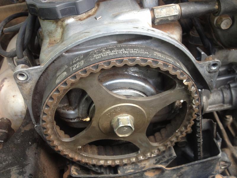

    I know the book can be deceiving on the timing mark. The picture is not that clear. But I think your off by 1 tooth on the cam timing. Here is a good picture of what there should be. http://www.mightyram50.net/vbulletin...am-Timing-Mark I'm pretty sure yours should be the same. It's the casting mark just below the flat of the head. If it's not on the right spot then you will need to advance the dist as far as it will go just to make it start. Then it does not want to rev up. You can trick it to by opening the throttle slowly but many times it just slows down and dies. Does this sound like you?

    Well we double checked the timing marks. Everything seems to be straight. We came across another issue that someone may have put diesel in the tank. So we're going to dump all the gas and start fresh. And add some injector cleaner. We installed a new (used) MAF and I'm going to tow it to oreilly so we can get a read out on it. I really need to get this thing going so I'm hoping it is a vacuum issue. We can get it to idle still, it's pretty rough but we got it to throttle a little bit but nothing to build our hopes up. Could the diesel and vacuum issue be the main issue?

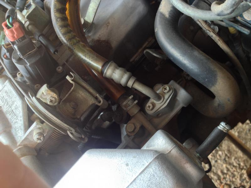

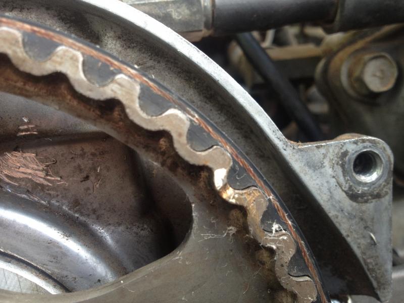

    Ok so I believe my problem is just timing from here on out, BUT I do have a couple questions, on my cam there is a mark in the teeth, now thats the mark we have been going off of, we cant seem to find another one, and I also spotted a vacuum line off of the backside (toward the cab) that is plugged with a screw, where is this line supposed to lead? Im so close to having this baby going, and I hate bumming rides from the ol lady to work. Here are some pics of what im talking about. TIA

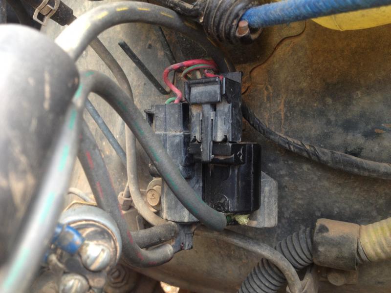

    I know the timing mark we have isnt in the correct spot in the picture, and the small electrical sensors are what I was talking about before. I southern engineered a new little nipple on the cleaner looking one so that i could connect the line again.

    Just got my chilton today. And upon some more research I believe the main issue is my "egr solenoid" (cleaner looking component pictured above) problem is, I cannot for the life of me find any way or any site to buy a new one. Not even rock auto had the part. Can someone please show me where I can find one.

    To adjust the base timing you need to ground out a plug on the fender. LSRMike has a picture of the plug. Look around the site you will find it all over the place.

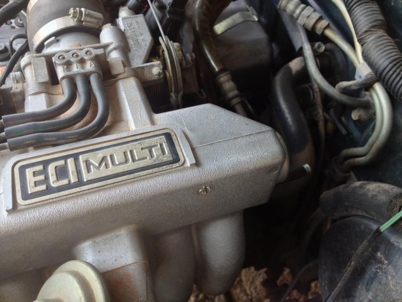

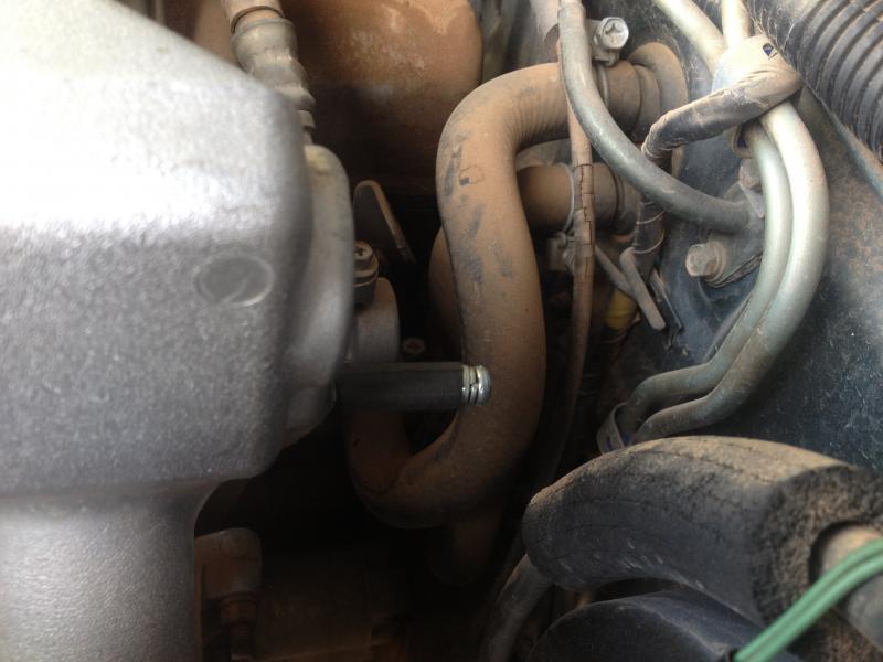

    Well the timing seems to be the closest I can get it. My main issue is the sputtering at low accelerating speeds. It spits a little at high RPMs but not as much as the lower end. It idles absolutely fine, but I think a vacuum issue is making my ecu dump fuel, because its running very rich. And it sometimes dies when its shifted into gear or when coming to a stop. Everynow and then it feels like it does not down shift to first and has no power when leaving a stop, it just sounds really low and unhappy. I have been driving it everyday and it runs fine doesnt over heat but like I said i think its a vacuum issue. There is one line that is just plugged with a tube and a screw in it, it is located closest to the firewall, right behind the ECI MULTI emblem. when its removed it runs like garbage if at all, where does this line usually connect to? Sorry about the rant.

    The plug im talking about is the last picture posted above.

    I think it's the AC idle up solenoid.

    I have no idea where this connects to. I have searched hi and low for it in the diagrams but I got nothing. Camoit or anyone, if you have a picture or something it would make this so much easier.

    It should be part of the IAC which is on the throttle body closer to the rear

    I cant seem to find a part or nipple to attach a line.

    You mean that vaccum line on the intake? It doesn't go to anything. I had my engine out and it was open when I got the truck and me and my dad went all over the truck for hours trying to find what it could go to but mine looks IDENTICAL to yours. A hose with a screw. There's nowhere it CAN go. They had a plug from the factory that probably cracks and falls off with age. Turbo the truck then it'll be a perfect boost gauge port
