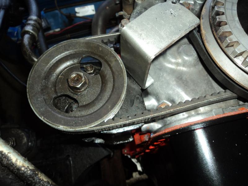

    here's what $70 gets you from the machine shop
    the only thing left is to bend the bracket for the VR sensor. then its time to fire it up. i'm hoping to start it this weekend... hopefully.

    here is the bracket i made to mount the VR sensor to. getting closer
    every time i think i'm gonna get to finish this lately, something comes up and i can't work on it. its so frustrating.

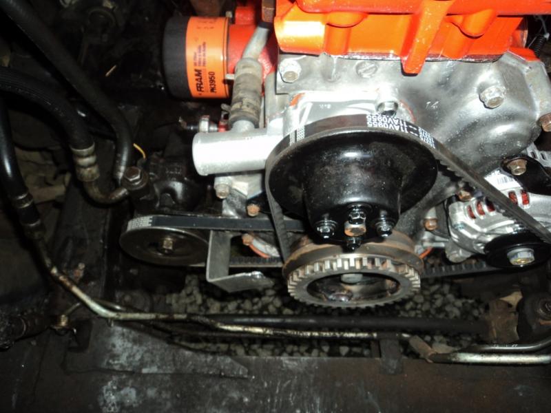

    got the VR sensor hooked up and lined up. tested the EDIS system today. it works because it shocked the crap out of me. the engine turns over nicely. the carb filled with fuel nicely. i've downloaded the software for the megajolt ecu and i will hook up the ecu on tuesday.

    i tried starting the motor a little bit ago and was disappointed that it didn't start. all that is hooked up is the edis module right now. it has spark, the VR sensor is about 1mm from the trigger wheel, but i'm get fuel blowing back out of the carb... like the timing is way out. the engine tried to fire when i initially turned the key. i'm thinking i'll wait and hook up the megajolt ecu then try it again.

    think you could have the cam timing on the exh stroke?

    i never thought about that. i made sure that the cam marker was at the top and lined up with the notch on the front cam tower. i made sure that number one cyl. was at the top as well. but then again, the cam could very well be 180 degrees out. i'll check it tomorrow. thanks for the idea. got my megajolt unit today and started the wiring process. pictures to follow soon.

    Make sure the crank sensor bracket does not vibrate. That might cause timing issue later on.

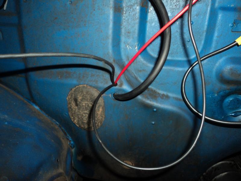

    got the truck running today. it fired right up after i got the megajolt unit hooked up. i would upload a video of it starting but the video is 200 something megabytes so here are the rest of the pictures i took today
    i put the megajolt unit in my glove box and ran the vacuum line, power, PIP and SAW, lines through the firewall
    i used the heater fuse in the fuse panel to power the megajolt

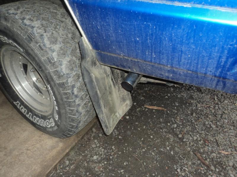

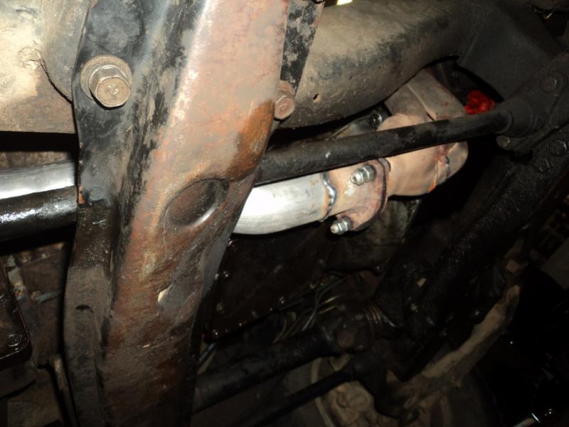

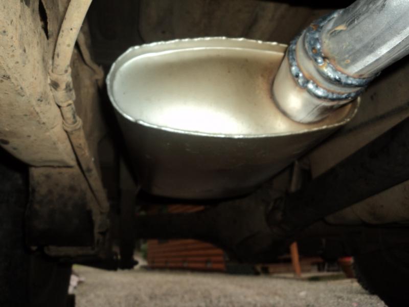

    here's the pictures of my duel exhaust
    quite a few years ago i learned that the exhaust is really hot on these trucks and that, at least on my truck, they go through mufflers if there is no catalytic converter. it took my exhaust guy and me awhile to figure out a system that works really well. what we found was that if you put a glasspack after the header where the cat used to be it saves the muffler from the heat of the exhaust. that and the fact that i had my muffler custom made at the exhaust shop for my truck.

    Is that glasspack glowing that color or is it painted that color (That looks BA if its painted like that), my cat on my truck looked like that when I first started to drive it, it was missing on one plug and running too rich, it got so hot that the passenger side of the truck started steaming from the water that was on the floor because I had had the door open when it was raining.

    a few years ago i got that glasspack glowing red hot out at the dunes on the coast. thought my truck was gonna catch on fire. no, its just the paint burning off cause its new. it sounds a lot healthier than it ever did before and boy is there more acceleration. i think i need to upgrade my motor mounts. they are new but they are stock replacements. i was thinking of upgrading to polyureythane motor mounts.
