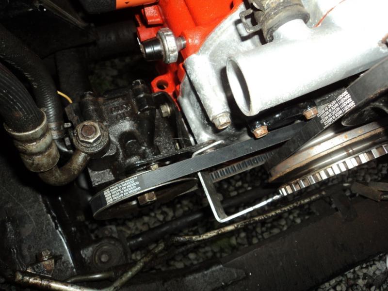

the only thing left is to bend the bracket for the VR sensor. then its time to fire it up. i'm hoping to start it this weekend... hopefully.
here is the bracket i made to mount the VR sensor to. getting closer
every time i think i'm gonna get to finish this lately, something comes up and i can't work on it. its so frustrating.
Looks good, glad to see someone trying something different, hope it works out just as you hoped.

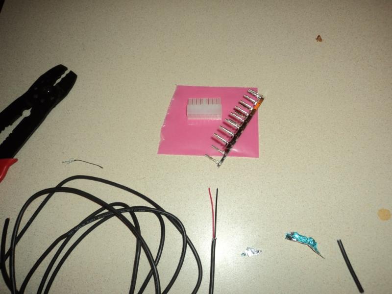

building the wiring harness that plugs into the megajolt unit
finished wiring harness

Make sure the crank sensor bracket does not vibrate. That might cause timing issue later on.

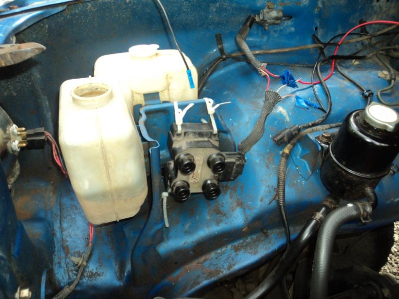

got the truck running today. it fired right up after i got the megajolt unit hooked up. i would upload a video of it starting but the video is 200 something megabytes so here are the rest of the pictures i took today
i put the megajolt unit in my glove box and ran the vacuum line, power, PIP and SAW, lines through the firewall
