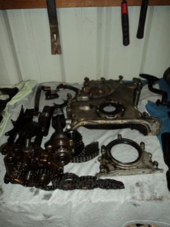

    i am currently rebuilding one my two 89 Power Ram 50 4x4's. the one i am rebuilding has a three inch lift that was done wrong that i have to re-do. the motor went out on me the day before christmas last year and have finally got all my parts together for the rebuild.
    this where it starts
    here is the motor torn down
