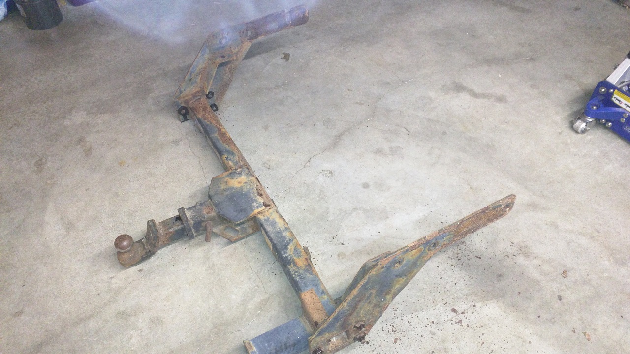

    I picked this up off of an 89? Toyota pickup last year. It's been sitting outside ever since. It looks like it'll fit my truck with some minor mods. But I'm worried about how deteriorated it is. There's huge flakes of powder coat and rust coming off.
    Even if it was brand new, I don't see myself ever towing anything bigger than a Harbor Freight trailer or one of the really small ones from UHaul.
    Would it be worth cleaning it up and painting it? Or should I just use it for test fitting and then buy a new one? Looks like they're pretty cheap.
    https://www.trailerjacks.com/index.p...roduct_id=1118

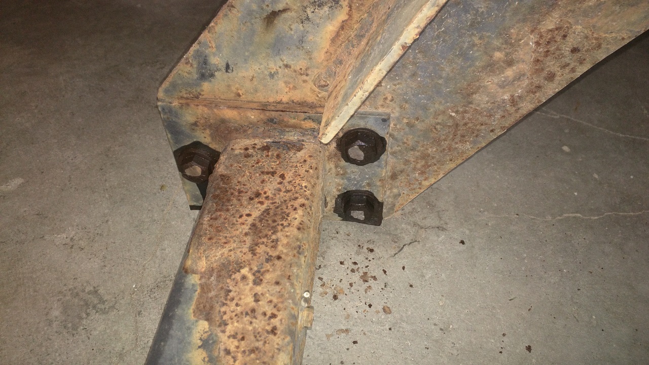

    Buzz over it with a wire wheel as the crusty powder coating and surface rust will mask the condition of the hitch. I think as long as there aren't any holes through the mounting flanges or tubing and the welds haven't cracked it will be useable. I bet there are hitches in worse condition that are still being used and the owner is none the wiser.

    I mocked it up today, and this is going to require more work than I expected. It's still possible, but I've got other problems to deal with before this can be a priority.

    I would cup brush all the rust to check for cracks. If there's no cracks I'd use it. If you only plan on pulling a harbor freight trailer I would think you could just use the bumper???

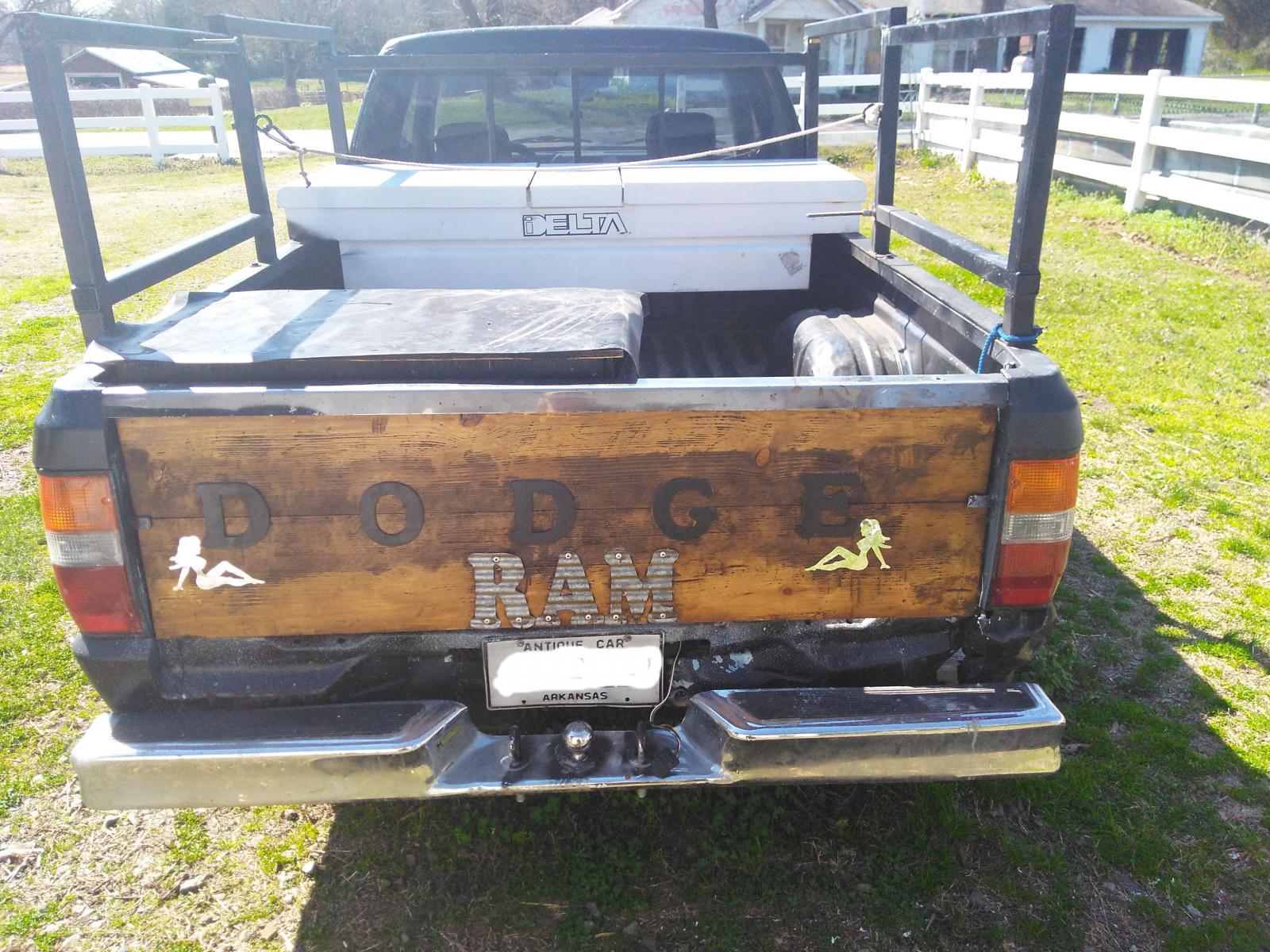

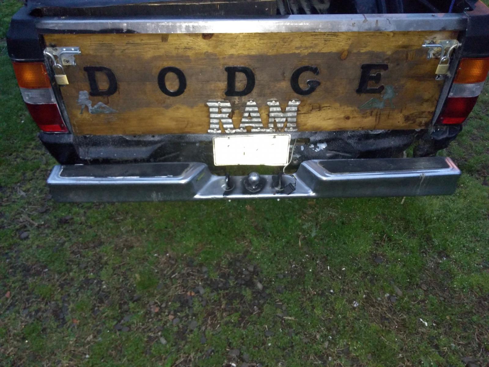

    you are right on this i bought that one from rockauto for my 88 got it in found out it was to wide. the good thing was i called them and they told me it had been listed wrong and refunded my money. bad part is i had to travel 30 miles one way to a fedx center gas out of my pocket i finally ended getting one from a friend of mine 4 mo,s later and had to have it modified to fit. then october.26 of last year had a pecker wood rear-end me @ 100 mph but the hitch save my truck because it was sticking out far enough that it took 70 % of the impact the tailgate and right lower panel took the rest of the impact. so when i went back with a trailer hookup device i went with a bumper off a 87 mm from a scrap yard had to do just a little bit of modding on it but not much. beside i thing it looks better than the hitch and plus it give me a step to get into the back of the truck if need be.IMG_20180321_152822182.jpgIMG_20180403_065033178.jpg
