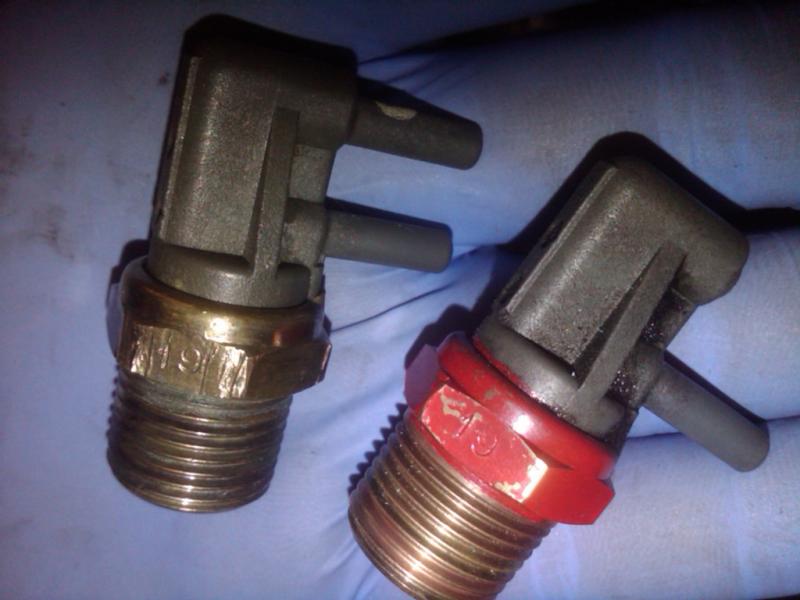

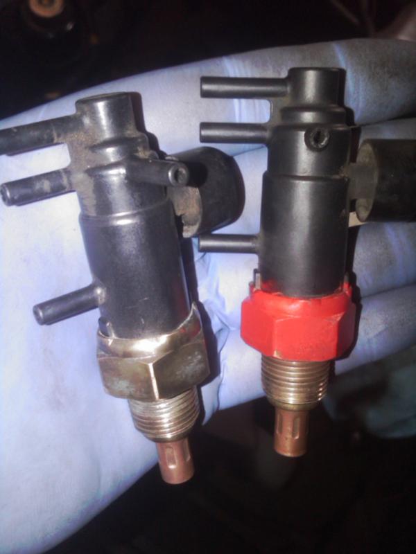

    posted in da wrong section.. but to answer ur question, I got both of mine from a local pick'n'pull. both are on da intake manifold...one is close to firewall (small w/ 2 vacuum lines connected to it) and da other is under manifold below thermostat housing (bigger w/ 4 vacuum lines attached).
    see pic attached (red paint marks my old ones, da other ones are from pick'n'pull)

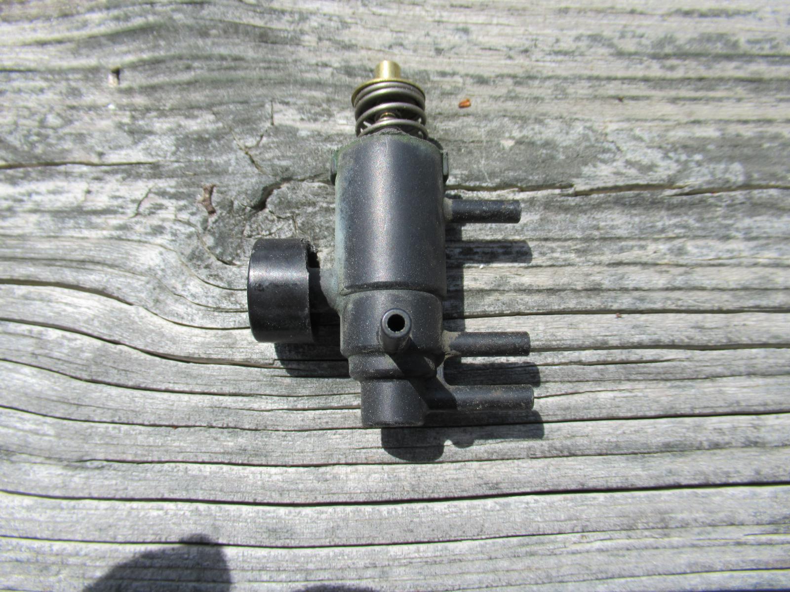

    IMG_0201.jpg well here's what mine looks like, lucky I live in an area where we don't have emission testing BS to worry with. I just capped and plugged all those lines to it and kept on going down the road. I love it where I live, we can drag an old jalopy back to the house on a chain nobody even bats an eye here !
