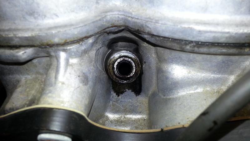

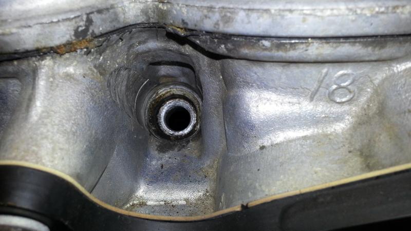

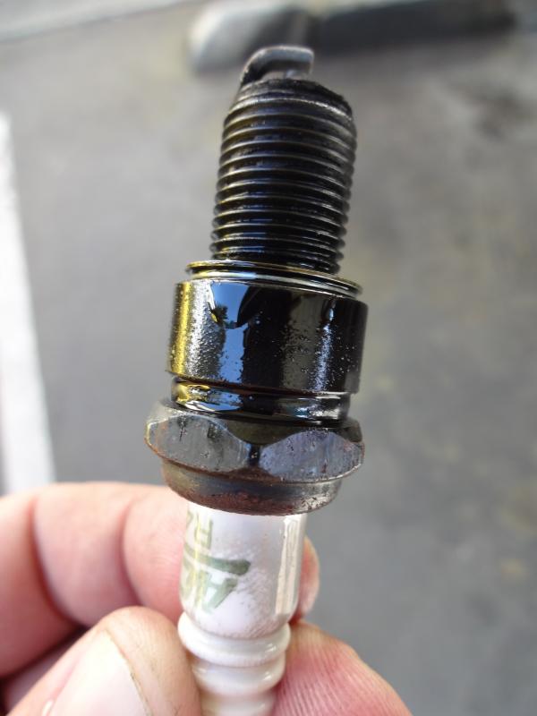

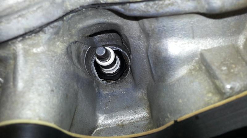

    So I have been noticing that I have had a lack of power for a while, a long with some oil consumption (but not leaking oil). The other day I went to change the spark plugs since I thought it might help, only to find some fresh oil on the base of one of the spark plugs.
    I took these pictures of the spark plugs in order starting with the cylinder closest to the firewall. That is the cylinder that the spark plug, from above, came out of. It also tested slightly low in a compression test.
    Thoughts?

    so what is the compression test show per cylinder?
    10-08-2012
    371
    Cali
    piston rings? similar symptoms mine had before i tore into it and had it rebuild.
    or could be valve seals maybe..
