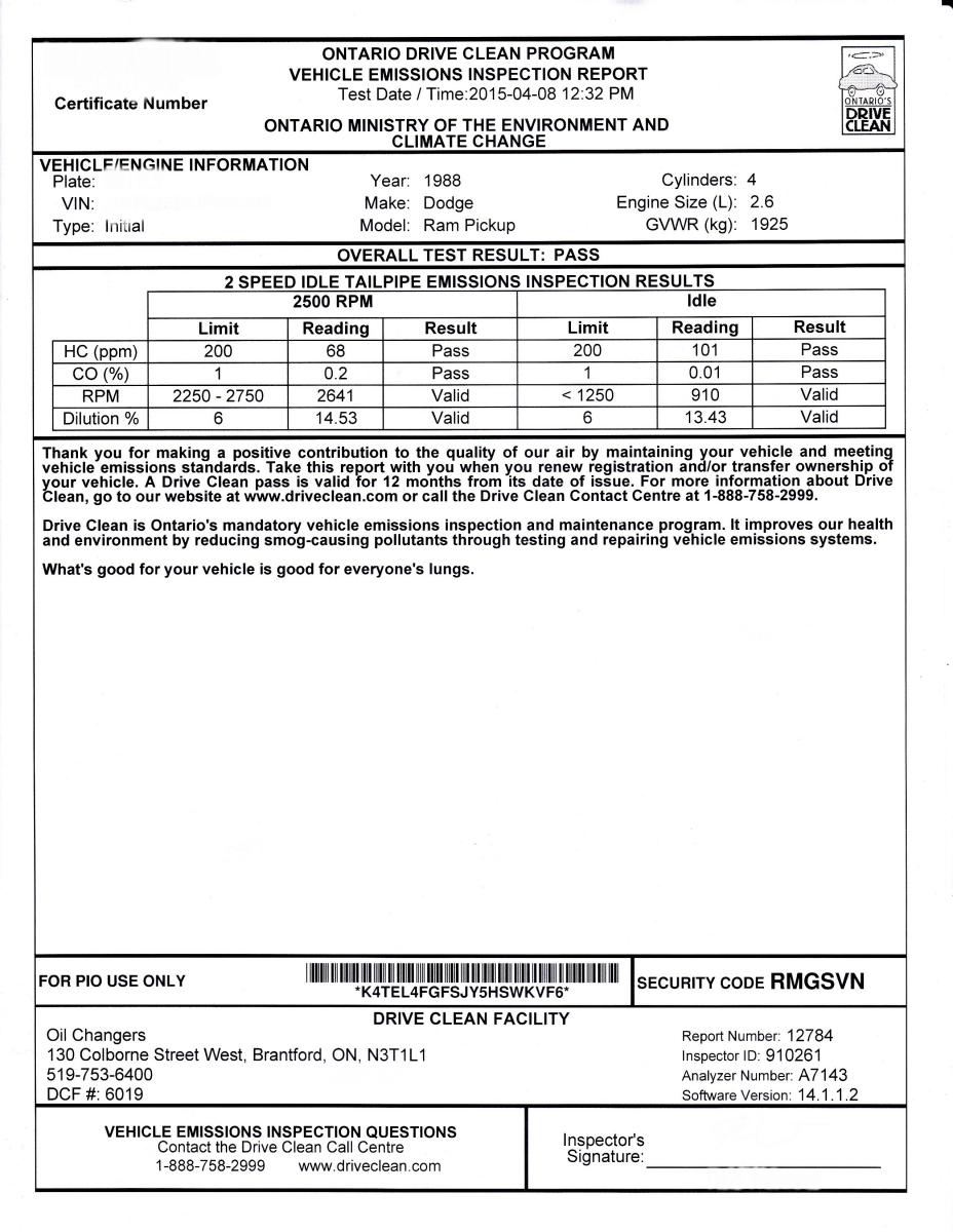

    I took my 2wd in for emissions last week and it passed no problem. I installed the Weber last fall and have been concerned about the emissions test. I leaned it out to the max for the test and had a full tank of premium fuel. They use a 2 speed idle test with a sniffer in the tail pipe. Here are my results.

    They don't even measure NOx, that sure helps!

    They don't use the dyno any more. I have a vacuum line going from the EGR to that aluminum box on the fender just to pass the visual. It does nothing.

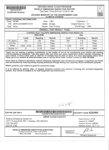

    That's is a TON better than what my 91 with Fuel Injection tested 2 weeks ago on the Ontario Emmisions

    Well it still passed. Have you ever had the cat replaced?

    No... they said I probably need one. Probably an O2 sensor also.
    Your runs really clean compared to mine.. that's for sure
