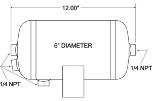

    I'm so cramped for room under the box with all my suspension parts only a 1 gallon air tank for now since I am still static up front

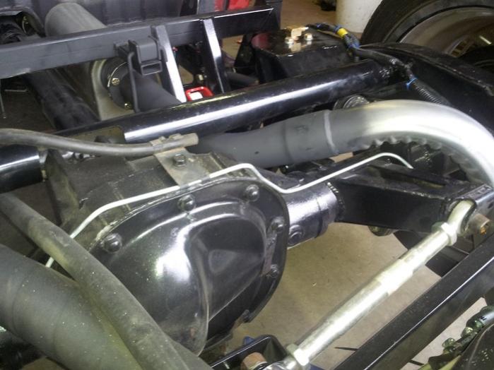

    I really hate the exhaust pointed down giving me that Yard blower effect on a 15 year old gravel drive way, next complaint the Rumble under the truck and lastly how ugly it looks.
    I've been brain storming trying to get the exhaust out from under the truck. Sounds stupid but I must cross and tie the tail pipe to get out. You see where I need to be and the notch I already cut out for clearance.
    It would be a tad easier if the stinking fuel tank wasn't there, but the brace is my heart burn for now.

    Cut it all off then just dump it under the cab(i know leaf blower effect still)
    Can you run the pipe under the axle then do an S bend using 2 45 degree elbows to run along the frame beside the gas tank to dump out the back. Fill the bags to their full height and see if there is clearance, then dump the bags and see if they would scrape. I almost ran into the same problem so I put the mufflers under the cab and modified the middle x-member to pass the pipes through.

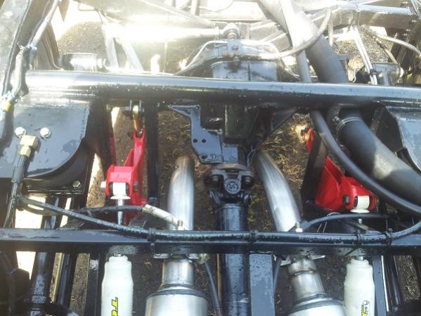

    Yep after 20+ hrs laying out the exhaust I had the whole system ceramic coated inside and out except the mufflers. The original system was a duel 2.5" kicked to the passengers side into a duel in/out muffler then dumped under the box in the factory location. OMG was that annoying at 65MPH@ 2100rpm the drone was freaking stupid.I love how many people freak out with the new set up dumping out the lower front 1/4 panel of the box and I don't have to worry about crushing the tips on a speed bump.

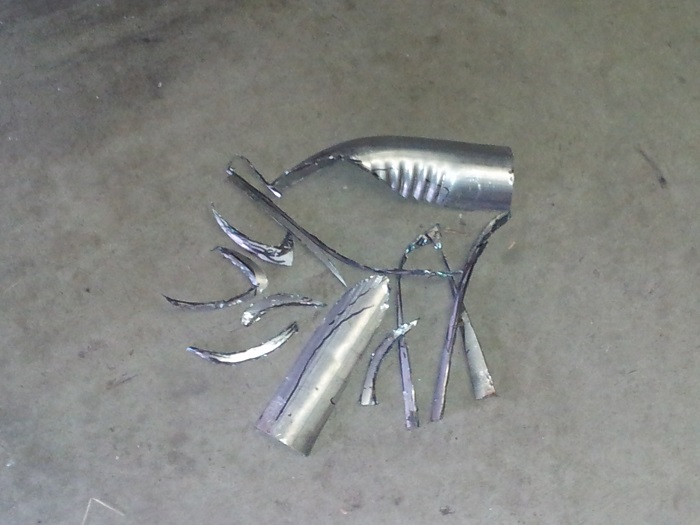

    Amazing how long you lay under a truck just staring and thinking no doubt I am a professional procrastinator.
    The way I figure it is orange county choppers can do it I can too, but you must start somewhere even if you do it wrong the first time, you can do it again.
    So with a zip cut disc on the grinder you start some where even if you screw crap up, I didn't but I’ve be working metal for a long time so this took me a couple hours, even less if I hadn’t loaned my plasma to a friend but now I really need it to notch the cross member. I do have friends with tubing benders but no dies to fit 2 1/4" and using a pipe bender crumples, dings, and flat out squishes exhaust pipe. As you can see

    Thanks man, I read up about what you're going to do with your truck and I know what you're going to experience, I'd suggest dry sump like the corvette has. The steering and oil pan was huge problem for me while the Ford and Dodge engines fit with no problem
    (Chevy rear sump, Ford/Dodge front sump). But we all know building a custom is truck, #1. it's your truck. #2. is a learning experience. #3. time consuming.
    This weekend is all about time consuming, About 20 hours later here's where I'm at.
    5 sets of flanges and ended up with 6 pieces of removable exhaust with no use of a saws all.
    I still need hangers but this is ready to weld.

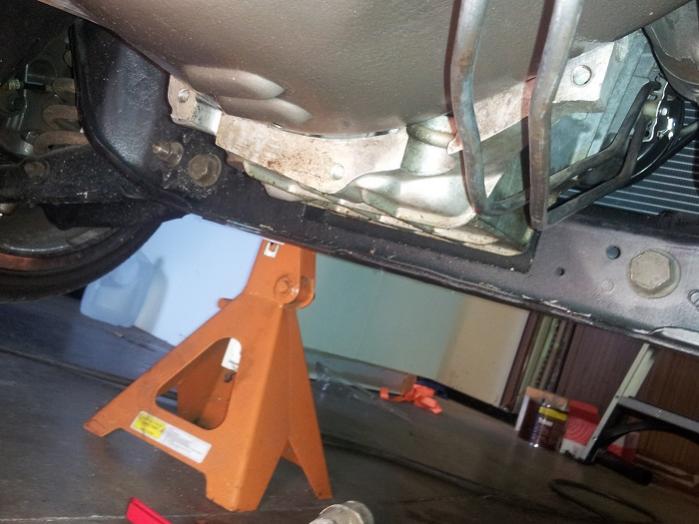

    My resolve was I cut the stock IFS off and put a 74 Pinto Ifs under it. I had to make strut pockets that look like crap on the frame but eventually I’ll cut those off when I get upper and lower tubular A arms with air bag shocks.
    Well, that’s my intention anyway. Oh and headers is another nightmare. I included pictures of old resolves.

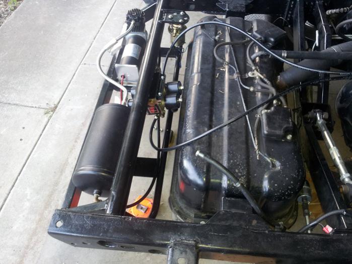

    I've been busy, I was trying to put all this where the other muffler was and I got stumped, My kids pointed out that I had so much room back here (another moment of, I couldn't see the forest because of the trees). I also fixed my transmission mount bolt holes that I stripped out, love them Heli coils, they are slick. I found 2 bumps stops off a Honda that I scrapped out and put them over my top links bars to rest on, so now my truck is also part Honda.
    @ 120 psi 6 3/4" lift at the compressor, 100 psi 6 1/4" lift.
    I do have some 1/8" aluminum diamond plate that I'm going to surround the air compressor and fuel pump, for one, to keep the compressor dry and 2 the noise. It's easy to say, just got to do it some how?
    The fuel pump was on inside of the frame where exhaust heat now is.
    Vary nice work. I went and got some MSD rubber stand offs and mounted my compressor on them,the compressor it not very loud when running now
