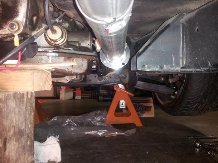

    I really hate the exhaust pointed down giving me that Yard blower effect on a 15 year old gravel drive way, next complaint the Rumble under the truck and lastly how ugly it looks.
    I've been brain storming trying to get the exhaust out from under the truck. Sounds stupid but I must cross and tie the tail pipe to get out. You see where I need to be and the notch I already cut out for clearance.
    It would be a tad easier if the stinking fuel tank wasn't there, but the brace is my heart burn for now.
    Here's what I've been thinking and I do always over build things.
    Question: Should I add cross bracing?

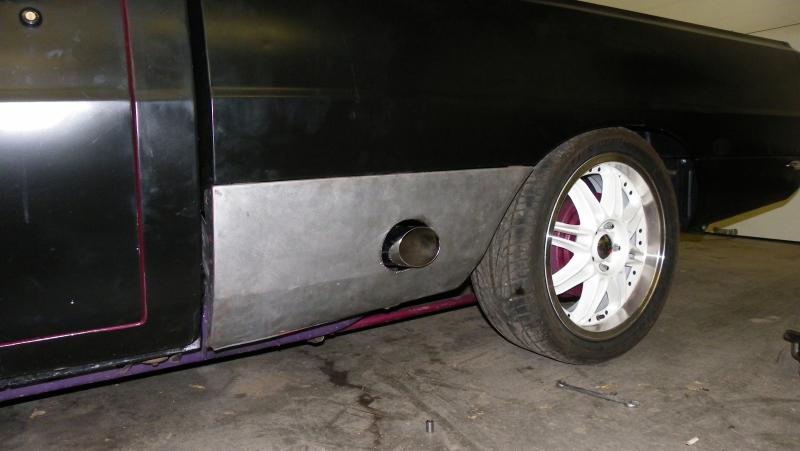

    Cut it all off then just dump it under the cab(i know leaf blower effect still)
    Can you run the pipe under the axle then do an S bend using 2 45 degree elbows to run along the frame beside the gas tank to dump out the back. Fill the bags to their full height and see if there is clearance, then dump the bags and see if they would scrape. I almost ran into the same problem so I put the mufflers under the cab and modified the middle x-member to pass the pipes through.

    I read your post a couple days ago. That looks nice and clean, did you have those ceramic coated?
    You made me think about a Y under the cab, then going single out is my best move.
    One of those times of, I couldn’t see the forest because of the trees. The thought of cutting that cross member is gone.
    I’m running small catalytic converters and their under the cab.
    Oregon, these old trucks still have to pass DEQ, so the first time I made a slip on with spring clips a dual to single tail pipe so they wouldn’t have to crawl under the truck and reveal it’s not stock.
    (It’s a closed hood inspection and just needs to blow 86 emissions standards, so I play it safe.)
    Deflated with it on I can lay (my hack job) exhaust pipe.

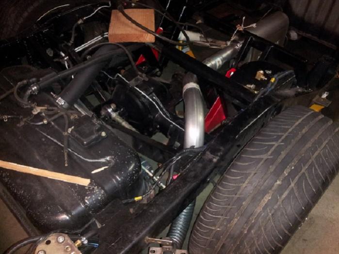

    one baby step is a step
    Amazing how long you lay under a truck just staring and thinking no doubt I am a professional procrastinator.
    The way I figure it is orange county choppers can do it I can too, but you must start somewhere even if you do it wrong the first time, you can do it again.
    So with a zip cut disc on the grinder you start some where even if you screw crap up, I didn't but I’ve be working metal for a long time so this took me a couple hours, even less if I hadn’t loaned my plasma to a friend but now I really need it to notch the cross member. I do have friends with tubing benders but no dies to fit 2 1/4" and using a pipe bender crumples, dings, and flat out squishes exhaust pipe. As you can see

    exhaust
    Thanks man, I read up about what you're going to do with your truck and I know what you're going to experience, I'd suggest dry sump like the corvette has. The steering and oil pan was huge problem for me while the Ford and Dodge engines fit with no problem
    (Chevy rear sump, Ford/Dodge front sump). But we all know building a custom is truck, #1. it's your truck. #2. is a learning experience. #3. time consuming.
    This weekend is all about time consuming, About 20 hours later here's where I'm at.
    5 sets of flanges and ended up with 6 pieces of removable exhaust with no use of a saws all.
    I still need hangers but this is ready to weld.

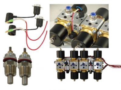

    Well I can officially tell you it was NOT the ignition switch that went bad, not three times. As I was searching for the problem I realized that I served myself a nice plate of wire spaghetti, after I pulled the seats and carpet to follow the console and tail lights , fuel sender loom. The STOCK Black wire with yellow stripe comes to a plug and turns 180 degrees and runs right back out the firewall. Nice goose chase Mitsubishi!
    After a all day search, I find the white 3mm alternator wire came off the positive battery terminal, no power to the cab, no power period. But I’m now happy, happy, happy!
    I cut this from the rectangular tubing, I figured the grained looked wood match the dash stainless. This is a 400 finish and much to fine
    Airbagit tried to bone me, this is their loom they sale with their air valve kit. They suggested to just tape over the cuts. I came unglued on them for even suggesting that on a 9 year old truck build. It’s a junk wire loom and the wires are as big as telephone wire, if not it is! Once I told them to stop blowing smoke up my rear end they said they would replace it. The problem is their loom wire is smaller then the air valve wiring so I’m not using it.
