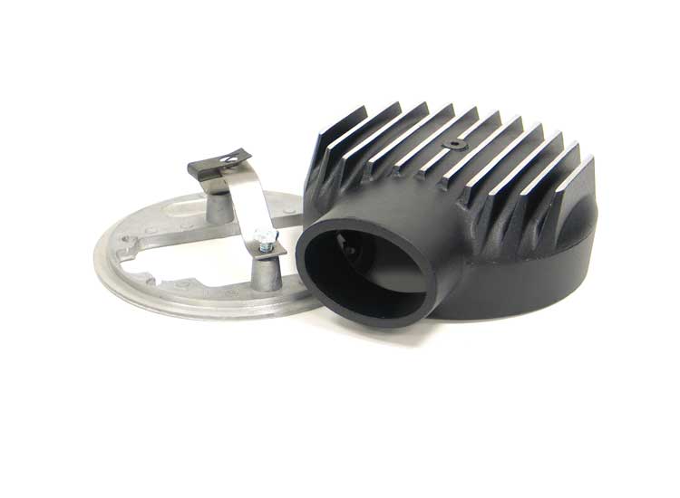

    I want to get a snorkel for my 88 Ram 50 but don't know where to find one or what kind might fit up well with our trucks. Anybody have any info on this or have done this to their trucks?

    just get some pvc piping and make your own. they are very simple to make and there is a diy on how to do it here http://www.youtube.com/results?searc...be.i5QExjxnaN8. here's a couple homemade versions that are simple yet effective. all depends on how much body work you want to do.
    if your running a webber you'll want to get this...

    I do have a weber, do you have a link for where to find that?
    409
    Portland, OR
    http://www.knfilters.com/search/prod...x?prod=85-8921
    That's full retail...can do better if you look around.
    Edit: Found on Amazon for much cheaper-- http://www.amazon.com/K-N-85-8921-Un.../dp/B00062YJTA

    My Weber had a rectangle air cleaner not oval. Do they make one for that?
    409
    Portland, OR
    Tanzy, the adapter plate makes it so you can put the plenum on either the 32/36 or 38/38 no problem. From there, you either need a direct mount cone filter, a cold air intake setup, or like LittleRed, a snorkel.
