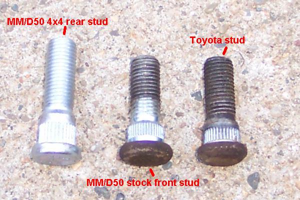

    the rear 4x4 studs are over a quarter inch longer. I used them for the front when I did the toyota 5 lug swap. They are Dorman brand available at your local parts store.
    info on old site http://www.mightyram50.net/phpbb3/vi...70&t=267#p1515

    you need front and rear? The rears are longer than the fronts. I upgraded to 14mm studs for Chevy wheels with the double nut, I have the old studs if you are just doing the front?
