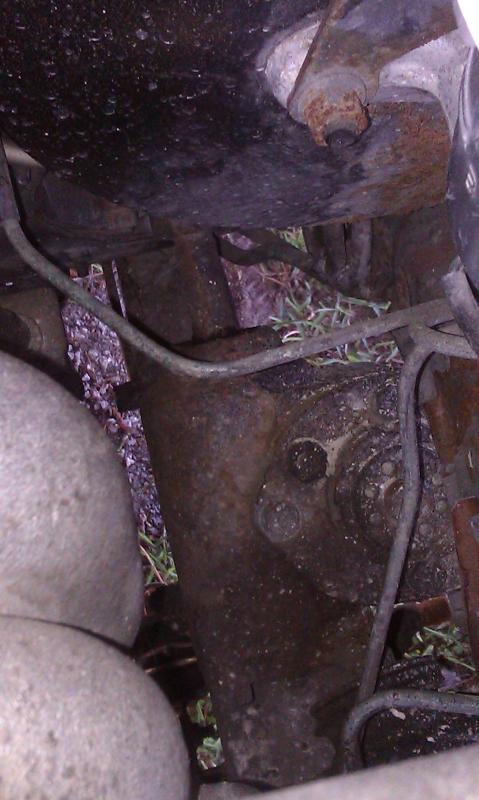

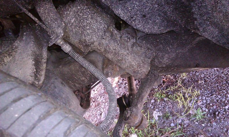

    We are talking 2nd gen trucks. This is for my 94. Here's my steering sector:
    Also I shouldn't need to modify anything in the steering system. I plan to take it loose at the relay rod where it connects to the pitman arm and swap that over and keep my existing suspension since mine is in great shape
    if their both outboard, then it should work, but I have never heard of a 2wd truck with an outboard steering box.
    I thought I remember hearing somthing on that subject on the board somewhere... Oh well.

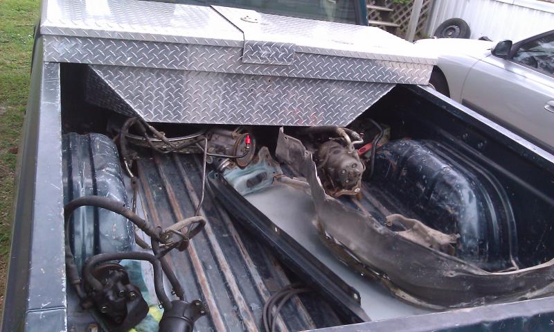

    Went today and it was untouched. Someone made off with the fan shroud tho.. Should have taken it since I'll need it for a/c. It's a totally different truck now that it's gutted. Me and my dad went. Showed up at 9. Left at 2. Mine has a good fender and a bed full of parts to convert. I've got the p/s pump with resevoir and lines still on it. Steering sector (outboard), compressor, condensor, accumulator, all lines, "Cooling unit" as it's written on the evaporator box, and all the wiring from the controller to the a/c button (in the control head) and from the controller, out the unit to the 2 switches and to the compressor and they hook to a blue connector on the driver inner fender. I took the dash harness just in case. I took the steering gear with the pitman arm since i know theyre a b**tch to pull in the yard without air tools and the pitman is really loose so I'm gona buy a new one before the install or I'd be doing the install tomorrow (payday is tuesday) I've got a box full of O-rings at work for retrofits so I'm gona change all the o-rings before doing the a/c and buy a new accumulator. I've also got some mint carpet that I'll be putting in tomorrow. May post pics tomorrow.

    Here's what I've got so far. Got a new fender and carpet for the truck too. Put the fender on today and painted it with some duplicolor rattle can that's almost the exact same shade of green. It's tempting me to paint the whole truck with it one panel at a time. I'll end up doing a step by step for anyone who ever wants to add these parts to their trucks. I looked at it today. All the plugs under the dash for the A/C controller are there and you just pull the glove box out, pull the duct out, install cooling unit + body plugs and plug in the button and control unit. Pretty simple. The rest looks easy too. It will be easier to install p/s before a/c since the pressure lines run under the compressor. Don't let the pic fool you. The tool box is slam full with the condensor, evaporator, lines, harnesses/hardware and light stuff. The heavy / fluid filled stuff is in the bed.
