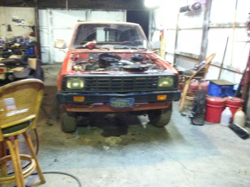

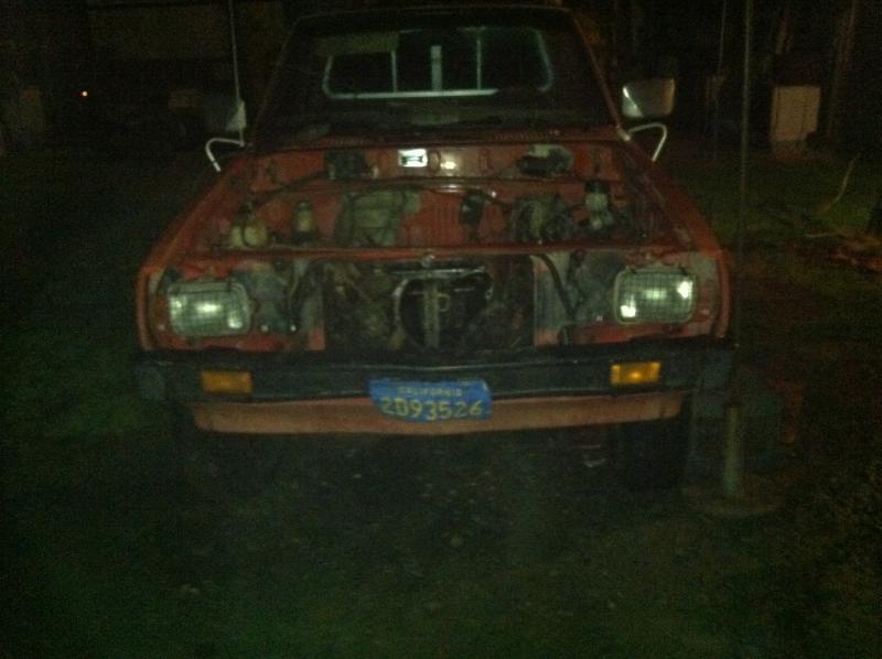

    Well about 5 years ago, I bought my first truck for $140, a 1979 d50 with the 2.0 and a 4 speed, then one day she broke... lost all the teeth on the lower gear drive on the crank shaft, after about a week of looking i found a 1982 Power Ram 50 that was r47 red. My girl named her Foxy Red she had a blown head gasket, cracked head and thrashed interior... so i took my two trucks and and made one good one. After some extensive top end work, welded the head and milled it ect... didn't last too long. Stupid terrible head design. Anyway long story short did another head gasket and trimming chain ... and had a leak in the hose from carb to the intake for coolant... and there went another head gasket.
    About 2 weeks ago i picked up an 85 ram 50 royal with a bad trans and shot steering but a running and smog passed 2.6L. I got if for a whopping $100 dollars and some stereo crap i didn't want. So i am engine Swapping for a fucked 2.6L to a better running one.

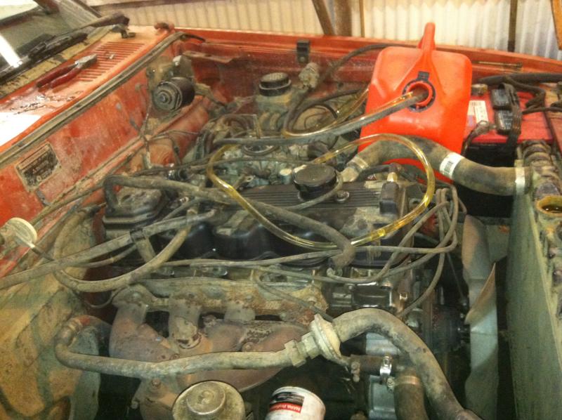

    The Gas can in the engine compartment is because she hand holes in the tank. This was after i got out of the air force and came back from Italy

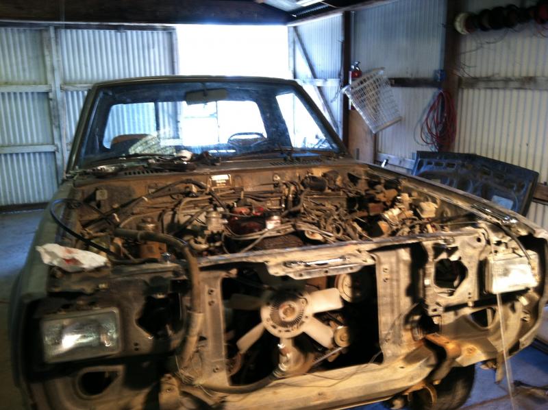

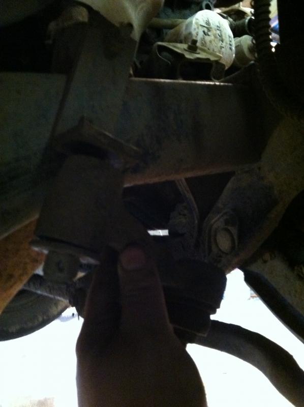

    1982 Dodge Power Ram 50

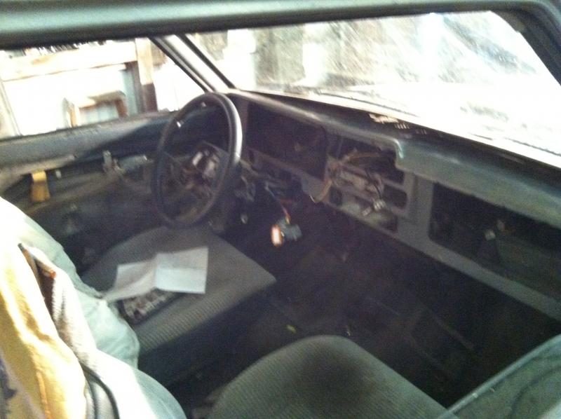

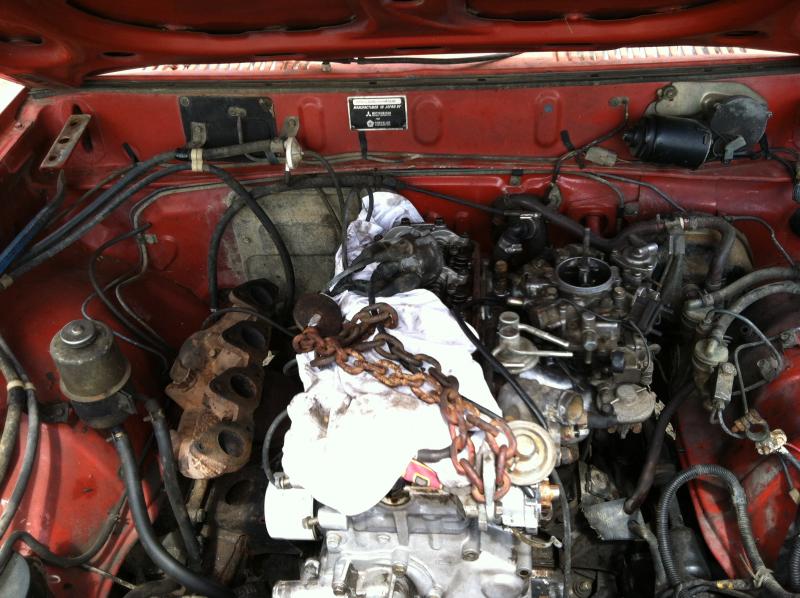

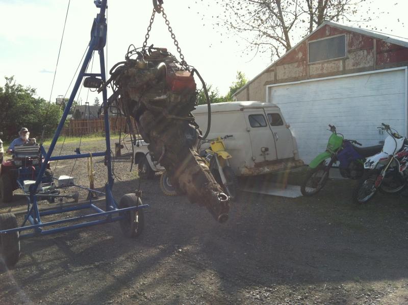

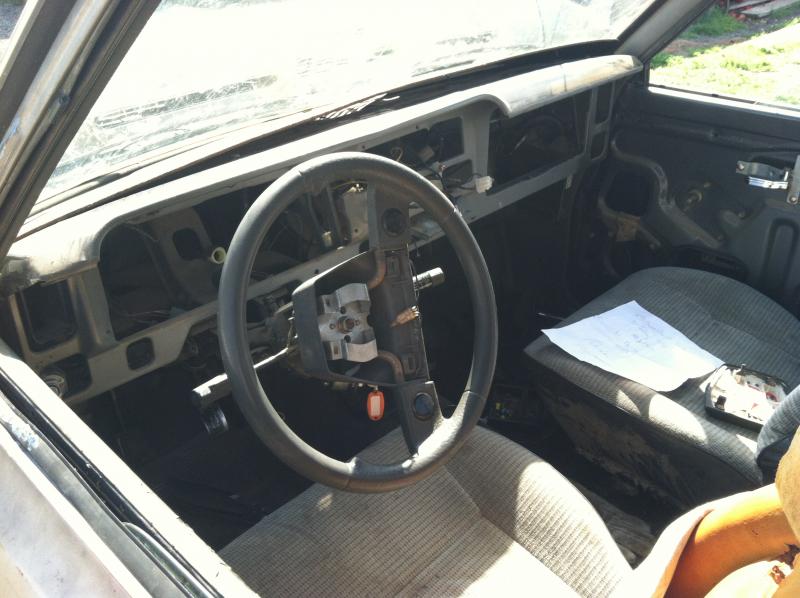

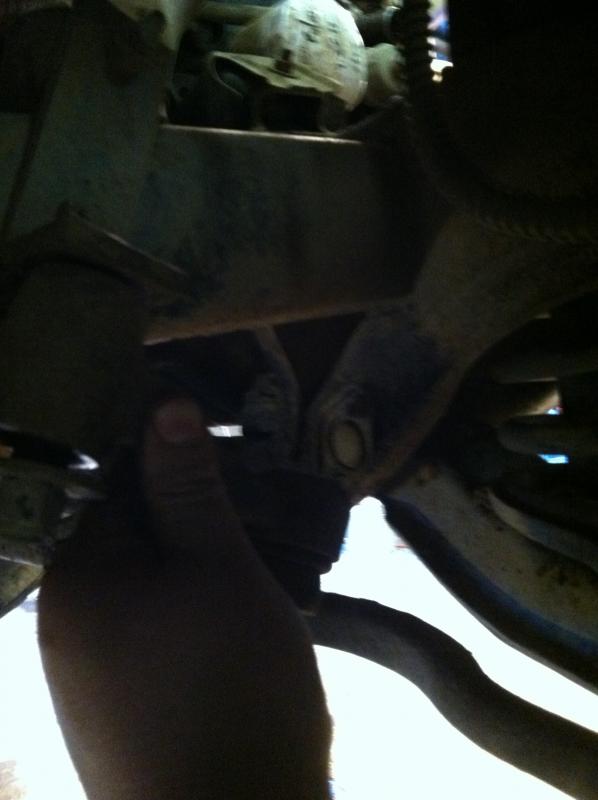

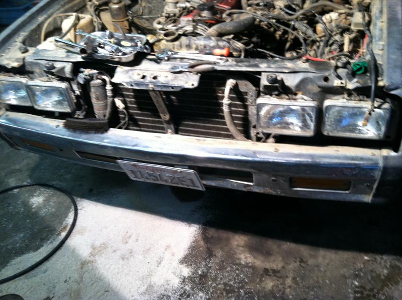

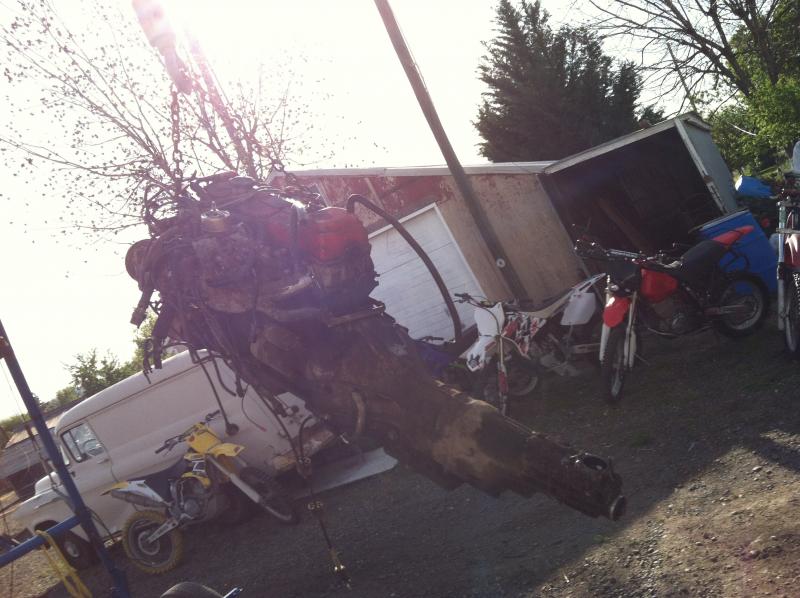

    The grey truck is my donor 85 ram 50 royal that i picked up for a$100 fucking sweet huh? well day 1 i got it home and started tearing the interior apart, a couple days after started on the engine... note the idler arm there, if you turned the wheel it would make a horriable click and wheels wouldnt move, after a 13hrs of work i endend getting both engines out, removed that bad trans from that 85 cleaned up engine and trans, turns out that Foxy had a brand new cluth and flywheel in her, not so much for the grey one.
    Few days later i put the 82 mikuni back on and but it on my engine, painted a few things on the engine valve cove, alt bracket, block, oil pan... later that day had everything ready to go lowered the better engine in to foxy started the trans bolts and guess what happened next....

    Nice, well no one guessed but the fucking oil pans are different to looks like I got some work this weekend.
    4,848
    You are the second one who missed my post in a thread about the oil pans and pickups were different 2wd to 4wd. Sorry I didn't see your swap post to warn you. Someone needs to put the info in the wiki about that so others won't get hung up with that issue.
    The oil pick up is different too? How so? Is it easy to change between the two? I will be digging into it tomorrow. Is my problem only really matter sense I'm going from 2wd to 4wd? So if u go from the 4wd engine it to a 2wd it shouldn't matter right?
    4,848
    if the 4wd motor is going to a 2wd, then is shouldn't matter, but since the crossmembers are different, then they may still need to be swapped. and the shape of the arm on the pickup is different because of the different shape of the pans.

    the oil pickup swap is 2 bolts and a gasket - there may also be an o ring on the tube that goes into the pump.
    11-10-2012
    128
    Esparto CA

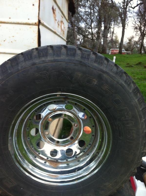

    Well the pick up was an easy swap just needed to make a gasket no problem o. After I got that oil pan on broke to pan bolt heads shitty it was very easy to get in and on the motor mounts and bolted in. Did get some new sweet ass wheels with some 31" tires. now that everything is in tightened up i cut out my old exhaust from a 2wd that i had in there.... but got in the exhaust for the 85, starter, intake ect, now need to find a good big diagram for the vacuum lines. then hopefully another weekend and she will be running.. heres some pics010.jpg013.jpg001.jpg
